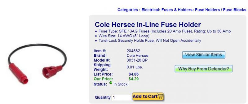

Change It ................
the bilge pump was wired directly to the battery and functioned even with the batteries in the 'off' position. I felt that this was the best way to have it wired and was wondering if I should change it on my O'Day.!
.............. and place an in-line fuse near the battery.
