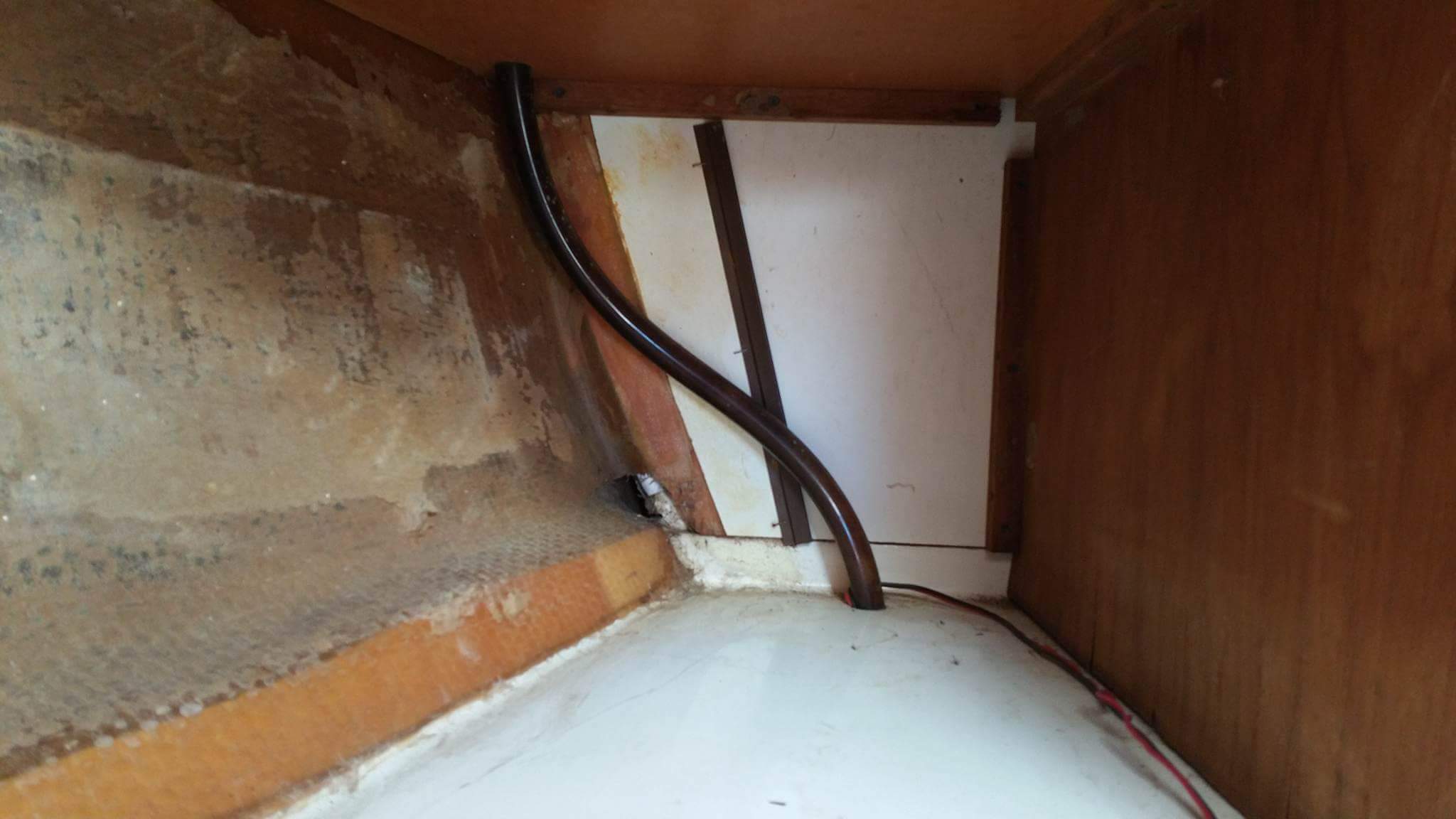

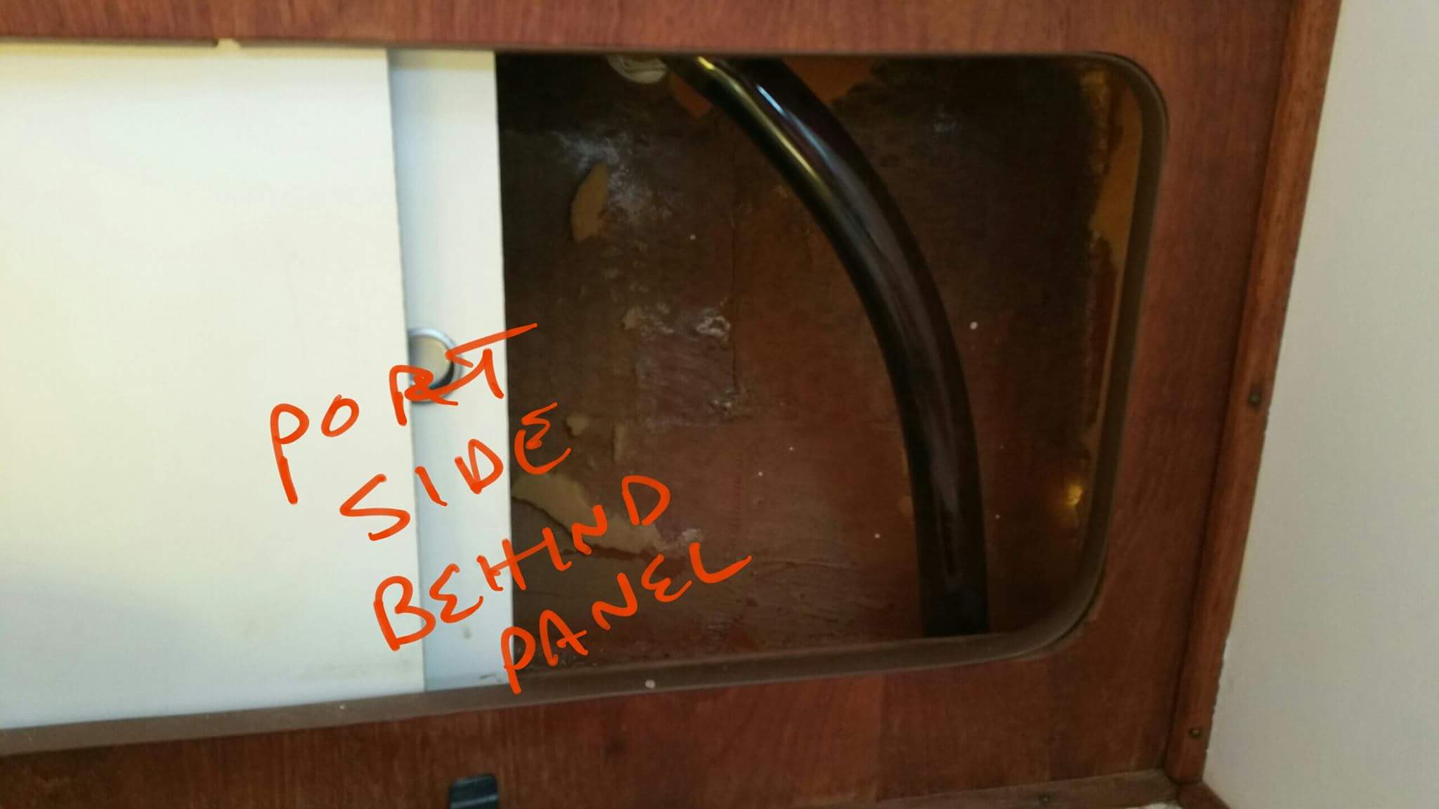

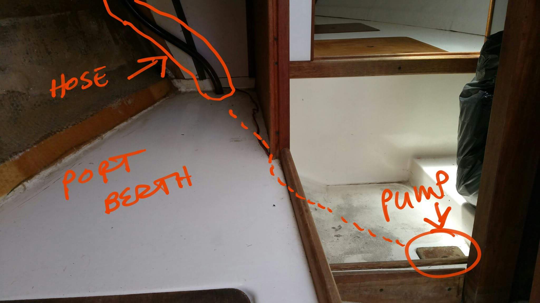

The boat did not come with one. I have a 79 25 foot. Mike showed me how to install one. It has to go in the small hole in the head area. You have to drill a hole in the port settee to get the hose out of the bilge. Then another hole in the port storage shelf in the head area, the one with the sliding doors. Then from there a hole in the hull for the through fitting. It is a real pia to get installed I can assure you but it is worth it. I can take some photos tomorrow when I go out to the boat.
There is only room for an automatic pump, not a float operated one.
