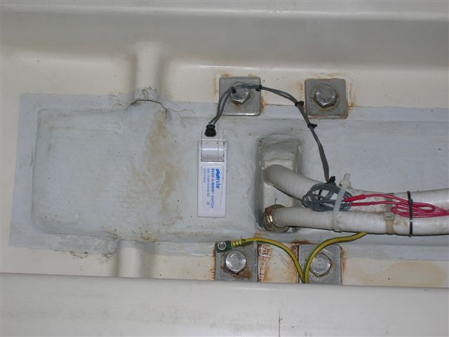

Why don't you add an automatic floating switch to the current electric pump and keep the Rule 1100 GPH as a back up ready to connect directly to the battery (in case of an emergency)?

The larger benes power the electric bilge pump with both a manual switch AND an auto switch, each on it's own breaker circuit. The auto circuit is always on, direct wired to the battery via a fused circuit. But your idea to install a stand-alone pump with auto switch is a better solution with increased redundancy. You would power it battery direct with a resettable circuit breaker on the DC board. In lieu of a switch, you install a button breaker that stays powered even when the DC main breaker is off. You may want to consider placing the auto pump in the low position, and the manual pump pickup at a high position. A bilge pump cycle counter and alarm would let you know that you have a problem and alert you to the need to power on the manual pump. Two pumps running would give you lots more gph capacity. Good luck.

I have directly connected it to the battery.
