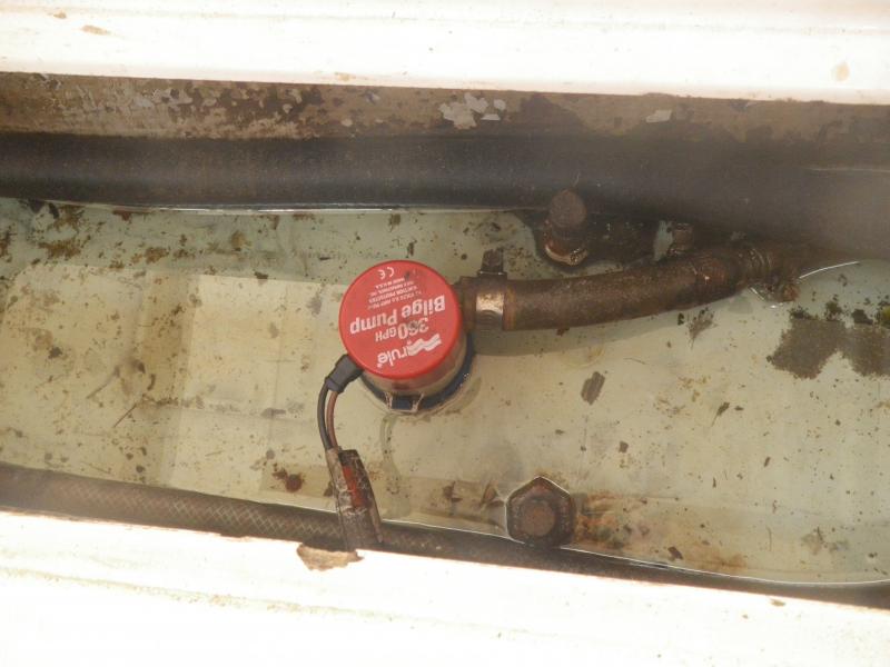

405
Catalina 380 16 Rochester NY
I have 2 bilge pumps installed.
One with a float switch that sits about 3" off the base of the bilge. It will never get used unless I have a problem. It runs off a 1.5" hose.
The other is a smaller pump running off a 1/2" hose. It will pump the bilge almost completely dry and as it's running I lift it up and place it in a small pot. When I turn it off, about a cup of water drains back into pot which I dump overboard...
These pics were from a few years ago....but the setup remains the same. The original platform was made of wood encased in epoxy but it still rotted. I redid with synthetic decking material which I just 5200'd to the floor.
Chris
