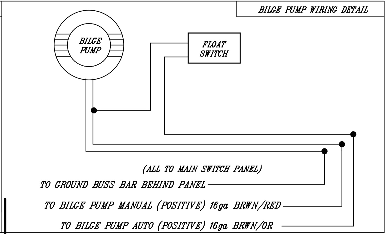

I'm beginning to suspect that the switch is bad. Toggle should not be illuminated all the time I believe, just when activated. Haven't opened up the panel yet. Anyone know what the switch configuration would be? SP or DP? Believe it SHOULD be off/on/momentary on. Hopefully the original is a Sea-Dog, found the exact switches online in their catalog in a number of configurations. Both float switches seem to operate correctly, although I may replace them also.
Dec 2, 2003
766
Hunter 260 winnipeg, Manitoba
Preferred switch would be on/momentary on. No off position. From the h240/260 manual here’s the wiring diagram.
Switch with led will normally indicate that switch is on and has power (some seadog toggles will give white light with panel light and changes to red when on) . Current draw on a led is minimal and gives visual confirmation you have power to your bilge pump circuit. When on/momentary on switches are not available I have seen off/momentary on switches used with the remaining auto power lead run directly to the battery or to a non switched positive bus.
