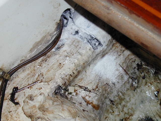

ft cabin and in the fore cabin and the main cabin too! I have not pulled the fittings on my sensors yet so I cannot compare my H34 with yours. Mine is on the hard so I do not have the same problem. Unless someone can go over the side and smear some sealant on the fitting, it will probably continue to leak. A long term fix will be to fix the gap in the fiberglass. I think a Dremel Tool with the proper bit should be used to open up the gap and then reseal it with epoxy. Then you can rebed the fitting and stop worrying about leaks. There were several discussions last summer on the pan and the problem with keeping the bilge dry. Limber holes can be added to drain the pan. Make sure the Icebox drains into a sump or you will always have a wet bilge when you use the box. I added limber holes in the bilge, between the pan and the hull. These holes are being added on all 4 sides of the bilge in order to remove trapped water. attached is a photo of the first hole I started. Didn't finish it yet cause my 25 year old Dremel tool finally bit the dust and I have to go buy a new one. The edge of the pan is glassed to the hull but the quality of the glass work on my boat is marginal at best as water seeps through a fold in the fiberglass. When I cut the first hole I got about four cups of water from the hole. I started at the existing wiring hole in the pan liner and carefully cut down through the pan and removed the fiberglass that was holding the pan to the hull in a space about 3/4" wide. Plan to do the same thing three more times on the other sides. I will finish up the new limber holes with some epoxy on all the raw edges and gaps and finally a fresh coat of paint to make it shipshape. There was also a discussion on water weaping up from the screw hole where the float switch and the bilge pump are mounted. The worry last year was that water was leaking through the keel/hull seam and leaking into the boat. Well my boat has been on the hard since November and when I pulled the pump and switch in February, water started weeping into the bilge by comming up into the bilge through the screw holes. When I winterized the boal last fall, I drained the water heater. The water is still somewhere in the pan cause It has not yet made it to the bilge. Unless of course the water heater is hooked to the schew holes in the bilge. Short of pulling the sole and adding lot of limber holes and then tearing out some of the fiberglass from the bilge and removing and reglassing some of the pan, I do not think I can get a clean and dry bilge in my H34. Hope this helps, sorry I do not have a good answer for the original problem
