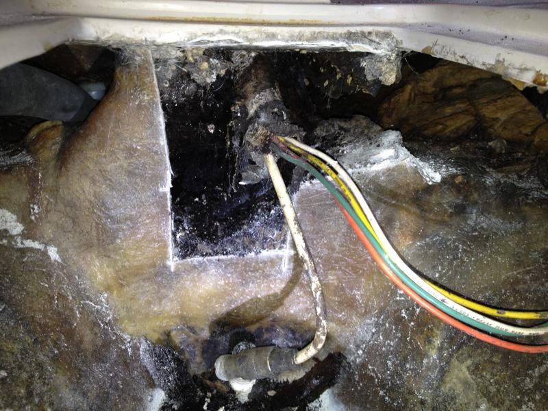

We dove into the compression block repair yesterday on our 1990. One of the previous owners did a band-aid repair by glassing in what looks like a wall to hold up the post. it was failing, so it was time to remove it. the first cut was to open up a window to see what is going on on the other side and what was found was about 5 pounds of rotted wood to the point of being mud. It was incredible... There was literally nothing holding up the compression post and i wouldn't have gone out on the water once had i known its actual condition.
I should mention, before i made the purchase i had a survey and the yard both look at this block, and they both said it was fine. My distrust of the "experts" continues to be affirmed..
At this point we have all of the original block plus the repair removed.. which included pounds and pounds of thickened epoxy.. i'll report back on the build up of the new block.. just wanted to share what i found so far..

BillyK, is the mast down? I opened up the compression post on our '84 and found a "waterline" about 2" up from the bottom of the post. Water was coming down the mast and following the wiring down into the compression block. Look back on previous threads, Old Skool Neil had a real cool idea to re-route the wiring into the head area. And I would suggest, if the mast is down, check the masthead and see if you need to make an aluminum plate to cover over the top of the sheaves.

Mast is down.. Yes, I will definitely see how I can Limit the water getting down inside the masthead.. I'll also do all the tricks to seal the mast step too..

What let me know I had a problem was the smell of rot when I stuck my nose down there and the crumbling of the wood when I poked around with my fingers. The deck was starting to compress as well at the mast step..
