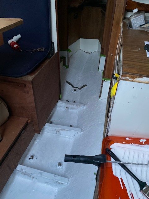

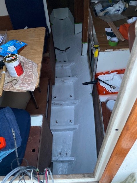

so my bilge is all clean, thanks to all of you.
tomorrow I'm going to paint the bilge and maybe do a first coat of ablative paint on the starboard side of the hull, still need some fairing on the port side.

Pics
Apr 8, 2010
2,161
Perhaps I'm looking and not seeing, as the saying goes... but is there a place forward where one of the 'floors' is missing?
In general its looking real good-- a smooth shiny surface is a LOT easier to keep clean!
