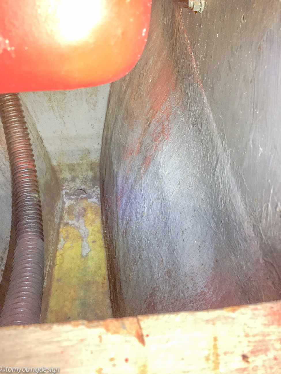

Our last boat had a deep bilge. After sitting at a mooring for a couple weeks, upon going below, your nose would wince.
Now with a much deeper bilge, that you can't reach, we have no odor problems. I chalk it up to this simple device:
Called a Garboard plug(which in this photo, the plug is removed). So for 7 months of the year, the bilge is drained of the last inch or so of water that usually lurks in a deep bilge. In the spring, you can put an extension on a shop vac and suck the dust-out.
We have a separate sump for the icebox that keeps any organic material out of the deep bilge. I have a manual bilge pump with a strum box on the inlet that rests on the bottom which leaves less than an inch of saltwater in the bilge. That pump also tells me instantly by priming, if we have a small leak somewhere.
The above and plenty of passive ventilation from cowl vents - which flow through the engine and bilge compartment - are our bilge maintenance through the season. No chemicals or cleaners needed. There are few smells worse than a stinky bilge.

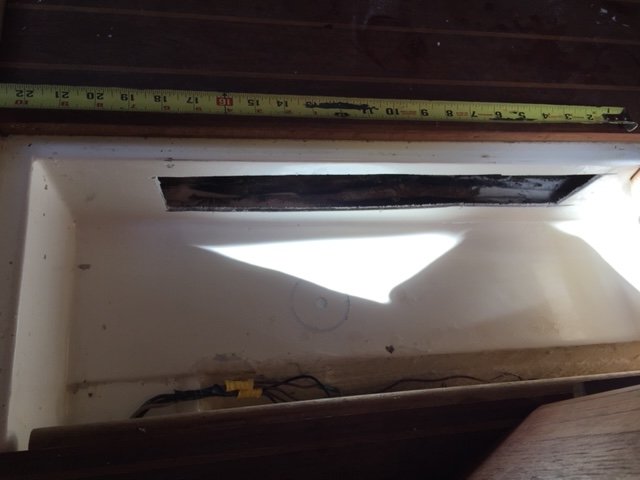

Oh,,,so much to share on this topic! Mine is a Hunter 31 which has a bilge, but also has a cavity between the hull and the interior lining of the cabin that acts like a bilge,,sort of. Water that drains from the ice box and from the motor area (along with any debris, diesel, etc.) finds its way into this (what I call) "false bilge". It turns into an organic chemistry experiment and your nose knows that something is very wrong. Several years ago I took a dremel tool and cut access holes into this cavity so that: 1) I can get cleaning agents into it, and 2) it will ventilate and dry out, avoiding future challenges (pic below). If it remains dry, all is well, if it gets wet or contaminated it needs attention. PREVENTION: I put a plug in the ice box drain and sponge it out after each use rather than allow that water to drain into "who knows where". I put a plug in the drain under the motor and use oil absorbing bilge diapers to collect any drips of diesel or oil. I use a small pump up sprayer with a wand and fill it with half bleach and half water and stick the wand into the access holes and every nook and cranny I can find and spray chemicals in before I go home each weekend. I open the bilge cover and run a high powered floor drying fan in the boat while I'm gone to keep air moving and moisture from building up. I leave the AC on while I'm gone to keep humidity down inside the cabin. All of this has helped immensely but is certainly a bit of a pain.
