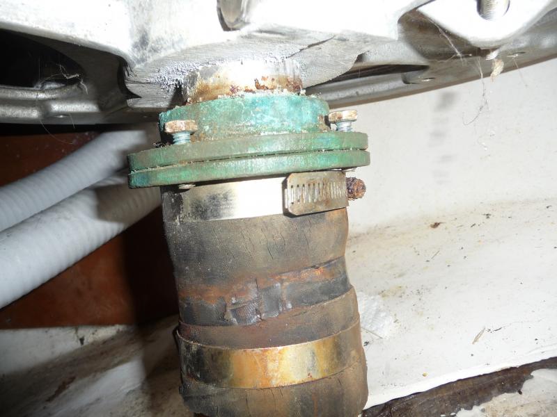

Ever since I purchased my 1984 h27 six years ago I have experienced more water accumulating in the bilge that expected. It is sometimes difficult to judge since melting ice from the ice box discharges to the bilge. I had always assumed that the source of the water was too much drip from the prop shaft packing. This was based in part on the recognition that the water leak was worse at times when the engine was pushed a little harder. Because of this I have always kept the packing adjusted as tight as I felt comfortable.
On a recent trip in the Pamlico Sound, NC I had a chance the set up the auto pilot and was able to check the packing drip at about 3000 rpm in rough seas. It was surprisingly light and while counting the drips, I noticed water splashing into the engine compartment from next to and under the muffler. I thought, aha the exhaust hose must be loose on the back end of the muffler, so I wiggled further into the aft port berth and peered and felt the muffler outlet, but no leak, although water was definitely gathering in the low area of this aft compartment. Then I noticed water running down the rudder/steering assembly.
Turns out there is a set of matching flanges on the steering assembly below the wheel devise where the steering cables are attached. These flanges are held together by four 11mm stainless bolts. There was probably a gasket between the flange faces. In my case, all four bolts were VERY lose - each took about 3 or 4 turns the tighten. By tightening these bolts, I have reduced water intrusion by as much as 80 %.
At rest, these flanges are above the water line, but at higher power, as the stern of the Hunter 27 squats, these flanges move closer the the water and in rough seas you get a leak. Three of the bolts can be reached from the storage locker under the helm seat. I would recommend any owner of an older Hunter check at least one of these bolts to see if any looseness is present. Good Sailing. Tony

Similar to Manny, one bilge pump in the forward salon area (I test periodically), but bilge never gets water. Shifted to a bin for my block ice to keep it from draining to the bilge. Used a turkey baster and a drill pump to remove past accumulated water from the area below the sole, through the holes where it is supposed to flow into the bilge.
Another place to check for leaks is the bow pulpit. I had water collecting under the forward v-berth. Had the wife run the hose at the base of the pulpit stanchions while I was in the v-berth with a flashlight. I watched the water drip in. The forward bolts drained directly into the bilge area and the aft bolts drained down the bulkhead to the cushions (now I know why the misses complained about not wanting to sleep there). All four bolts are reachable with a socket and extension. Ever since, dry as bone.
Another potential leak location is the galley sink drain. Two potential sources: 1) the hose connection to the sink not properly fit and 2) the hose may need to be replaced.
Mine had a vertical crack just at the height of sea pressure head, and slowly weeped into the bilge area below the drawers. A bear to replace if you are 6' 1" - requires squeezing into the starboard cockpit locker (just make sure you tie the hatch open, or have your cellphone positioned where you can reach it if you choose not to tie the hatch open)
