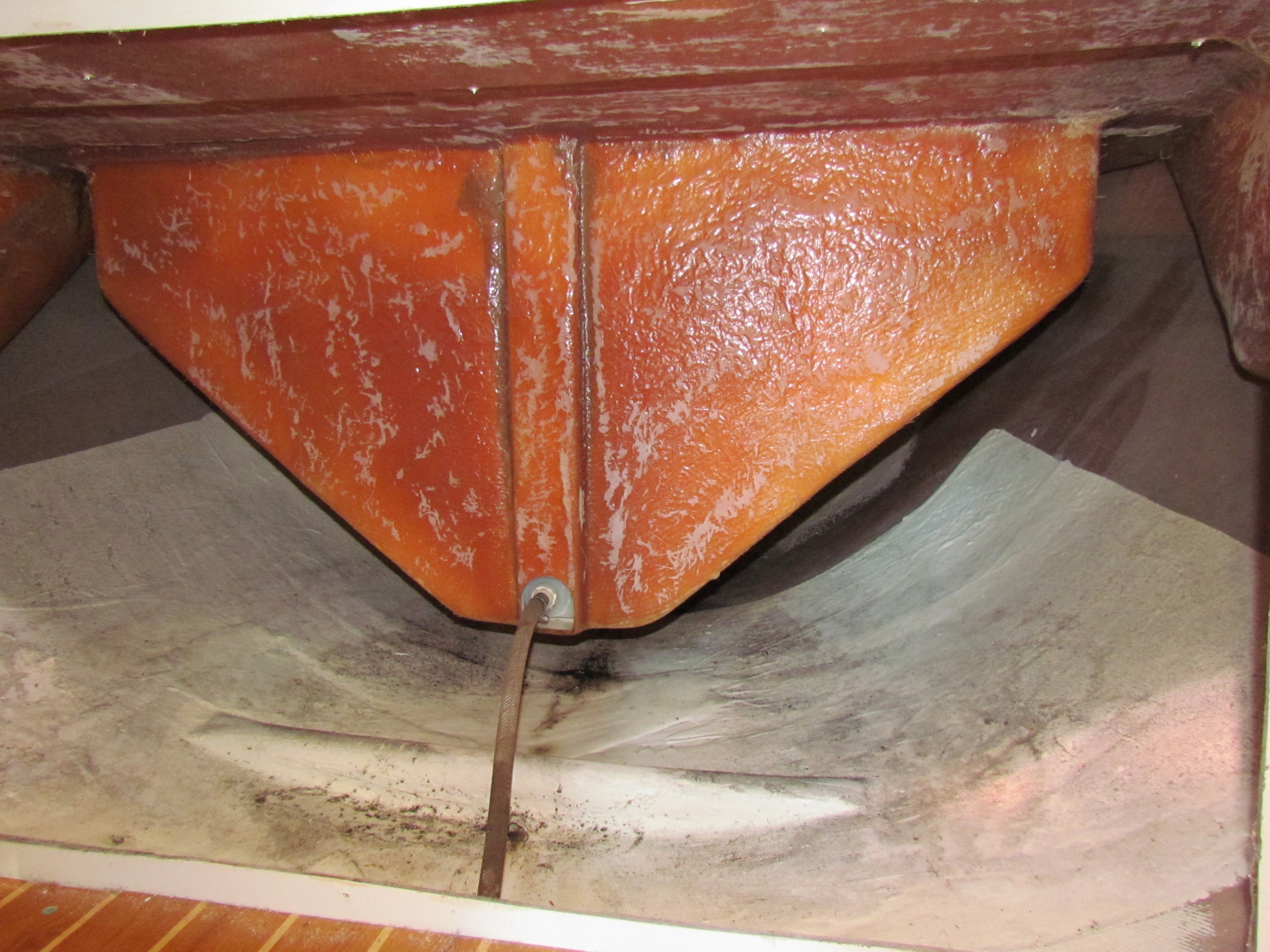

Hi has anyone put another water tank in the bow of a Catalinas 310
I was thinking about a triangle shape flexible tank ?
Any ideas ?

Hi Paul
Yes in that area under the other tank a triangle tank 200mm high
Taking 120 litres Trying to see if it well work ?

Mat,
I have been thinking of the exact same thing. I have a 100 L rectangular bladder I use to quickly fill our tank but have been thinking of getting a slightly bigger one to install where you indicated. I think you could daisy chain the two tanks together so you don't need another fill or vent. Essentially the hose would run from the existing tank into the bladder and then a hose would run from the bladder to feed the pump.
My biggest concern is how to attach it.
I have also considered two other options. One is to loose the bottom two drawers an install about a 200 L hard tank(50 G). But I don't want to loose the storage. The other is to remove the way too big water heater and either just put a water tank there, probably around 150 L rectangular would fit. Or a smaller water heater and a 100 L tank.
Anyone else have any ideas? We plan to tackle some of these upgrades when we get to Puerto Rico or St. Thomas in a couple of months.

hi Jesse
I was thinking of using a triangle tank putting behind the draws , there is a floor stiffener to screw the back two saddles off
and the front eye let up to the under side of the bunk ?
Was thinking about linking the tanks together and drawing of the bladder for the same reason you spoke about
well have to just give it a go and see what happens ?
