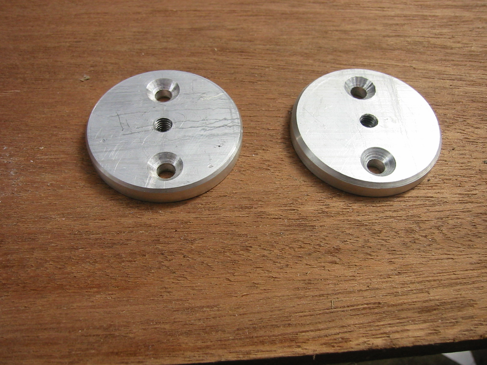

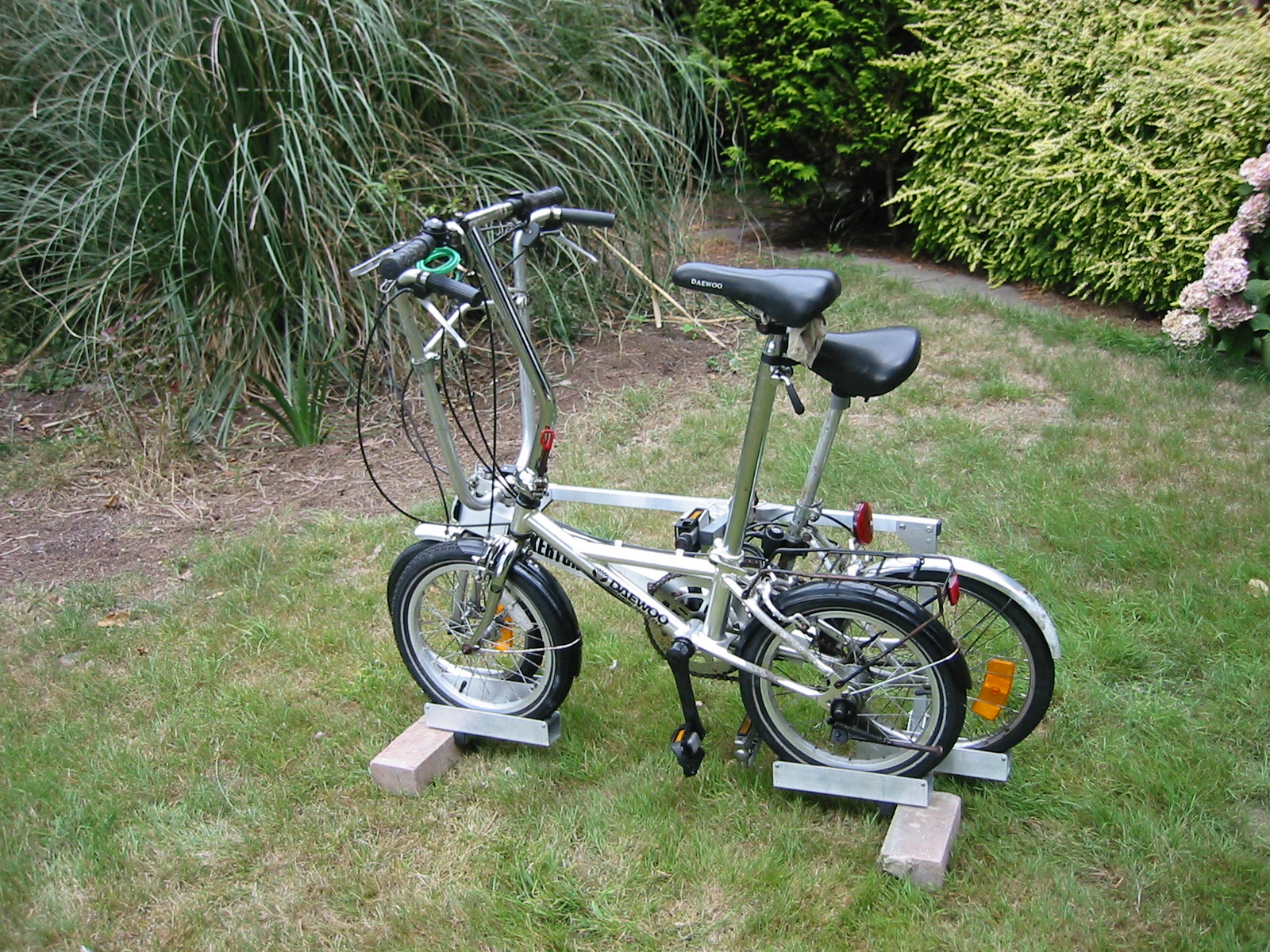

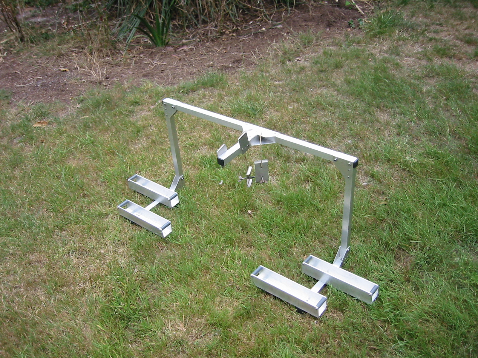

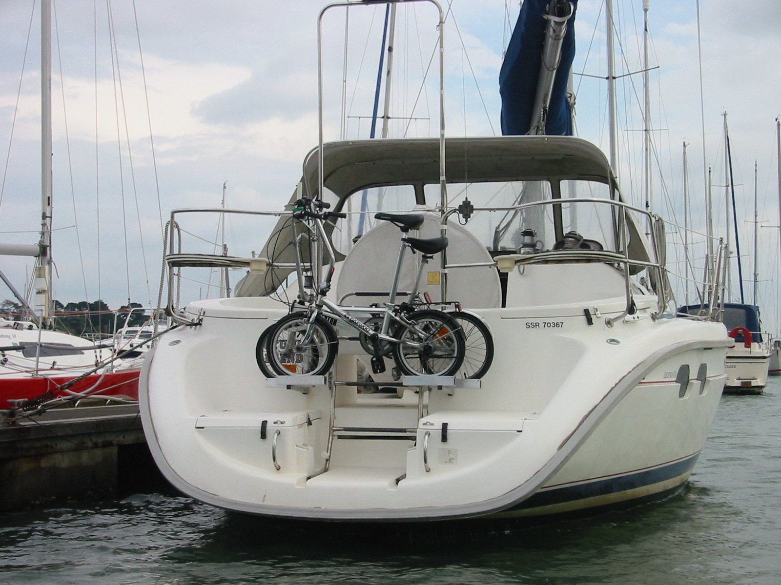

I made this detachable foldable rack for my two bikes. Okay so they are the folding type and smaller than a regular bicycle, but at least they don't take up locker space. Also when the bikes are at home they can live on the rack hung on the garage wall and it all travels in the trunk of my car.
The rack is made from 1" square aluminium tube and attached to the boat with only two 1/4" wing screws into two 2" round 1/4" thick aluminium disks permanently screwed to the transom. The bikes don't suffer much corrosion as they are out of any salt spray - but one still needs to keep an eye on them.
