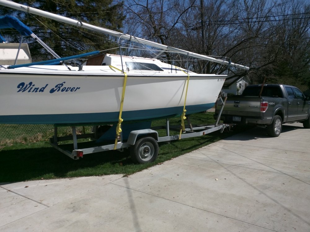

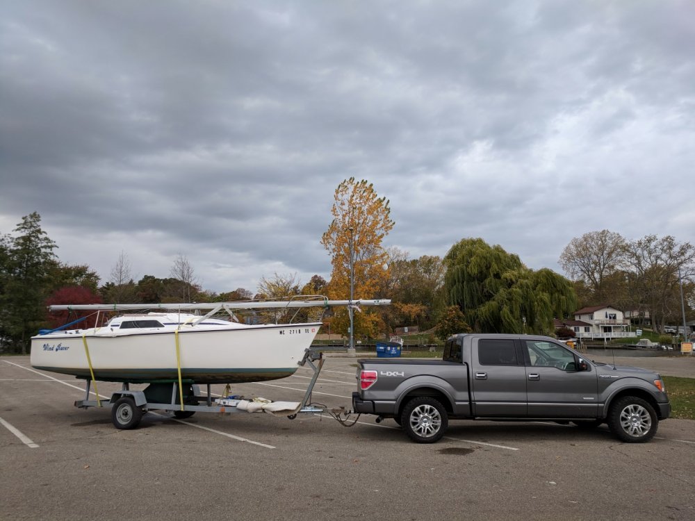

I tow mine dirty in the fall and clean in the spring. ;-) I just use two large rachet straps to keep it from bouncing (though I don't think it does much, the boat sits on the keep and I've never seen it move at all. I put the engine in the bed of my truck and I wrap the rudder in a piece of old carpet and rachet it down to the trailer in front of the keel. My boat came with a mast crutch that goes into the rudder pintles so I just strap the front and back of the mast down to make sure it doesn't bounce in transit. All in all, it travels very nicely even at 70mph on the highway.
