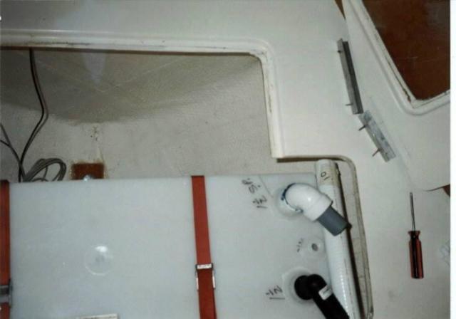

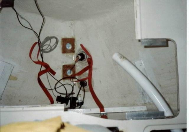

The previous owner of my 1983 37c also put a 24 gallon plastic tank in the v-berth. He cut the old tank out by going through the v-berth bulkhead. Now all 3 fwd storage compartments under the berth are full of white toilet hose, macerator pump, and toilet stink. I hate it.
(see attached image)

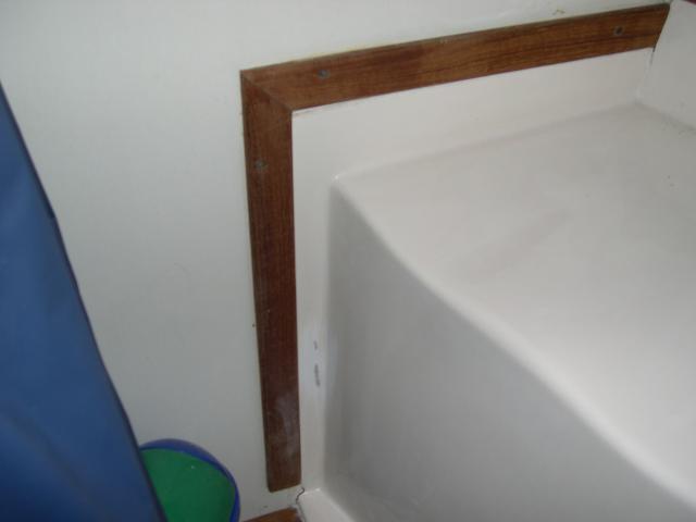

I've been thinking for a while that a good modification would be to make the shower seat removable. I would put the tank back in its original place and I would move the discharge thru hull, pump out port and macerator over to the right side of the boat as well. If you want to get fancy you can have a custom tank that holds more than 10 gallons. It would be worth the money to do this, just to isolate that pungent odour behind the shower wall.

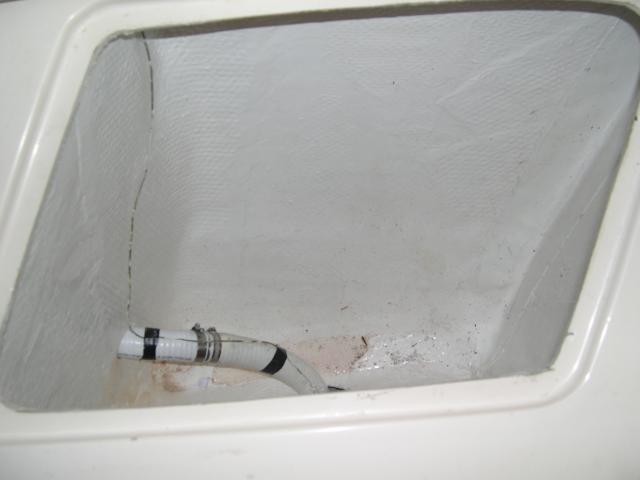

( I've attached a picture of the left-side of the shower seat. I think the teak is hiding the fibreglass edge of the shower seat ).

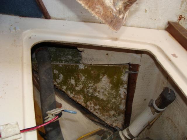

Why take the tank out? I cut out the shower seat and then the top of the tank. Cleaned out the tank and epoxied it. Now I have a great storage locker which doesn't stink. New holding tank under the V-berth. Will post a photo of the shower seat when I clean that area out for sailing.

Anyone have pictures of what 37C shower seat looks like after holding tank removal?
HI,
Anyone have pictures of what this looks like - boatyard wants to remove the front panel of the shower seat - then remove tank and replace this flat panel vice the top of the shower seat which is contoured for legs when sitting on it>
Any help would be greatly appreciated before we start cutting.
Jim

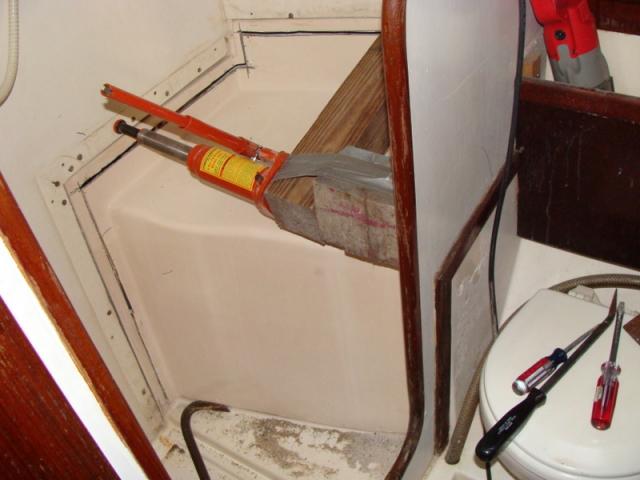

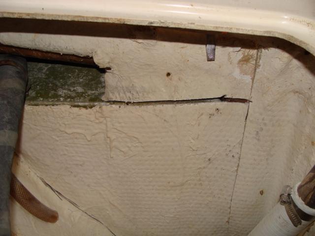

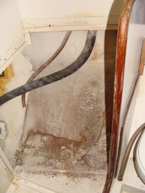

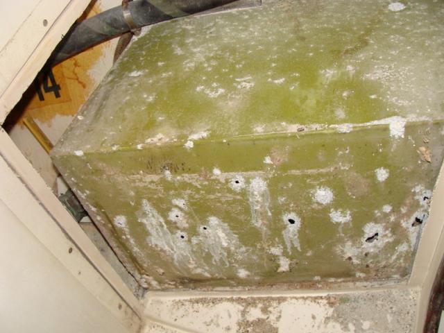

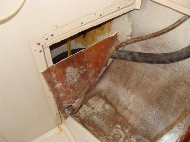

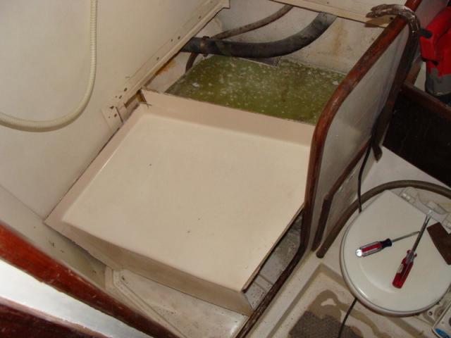

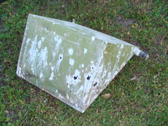

shower seat fully removed
Since my discharge t/h (stbd side) was located only a few inches in front of the holding tank, the cut/fold/pull removal method wasn't desirable due to the number of cycles that would be required. Also, I felt there may be value in having the odd-geometry tank intact for a pattern and I wanted real access for reconfig, cleaning etc. So, I removed the shower seat.:eek:
Notes:
I made an initial cut just above the tank in the fiberglass 'partition' between the v-berth and tank compartments. Then realized the whole 'partition' needed to come out since the tank was tabbed in as part of that piece.
Chose my cut geometry trying to incorporate keeping the bottom cut removed from direct sight (ie, low). This caused some cutting into the tank bottom (as well as the tank aft side) due to minimum clearances between the tank and compartment walls.
Although cut free, the seat would not simply lift out of place; it was confined by lack of clearance with the remaining structure. Bottle jack and crowbar gained the needed clearance (1"maybe) to remove the seat.
The tank condition speaks for itself. The built up 'residue' behind and under the tank (extending deep into the hull) validated the need to clean.
The seat cut was done with the idea of incorporating mounting flanges, reinstalling the seat, sealing, screwing and (probably) covering with teak strips. This would allow future access. Worst case scenario would be to faire and re-glass in as a 'permanant' install. (This part of the project is deferred due to more pressing items.)
