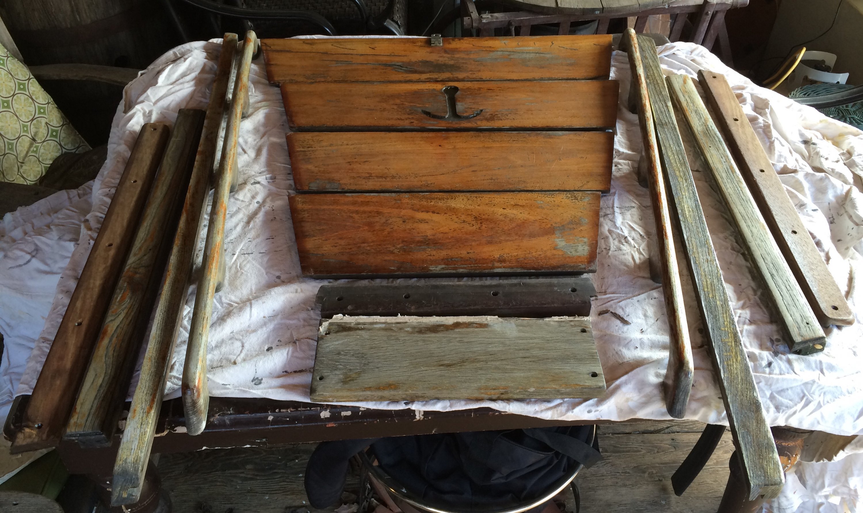

Time to redo my teak bright work for the first time. A couple questions from the collective knowledge pool. I have concerns about removing the trim not knowing how it has been fastened over the many years , has anyone experienced removing gel coat along with the trim? And I'm planning to use Cetol Marine ,teak or natural ? 3 coats or more ? And then re-bed with butyl tape? Best grit sequence for sanding?

C22BC
Jan 22, 2015
106
Catalina 25 Harrison lake
Got all the wood off , 3 screws broke off in the hand rails that is going to be a pain. Off to the Walnut blaster
