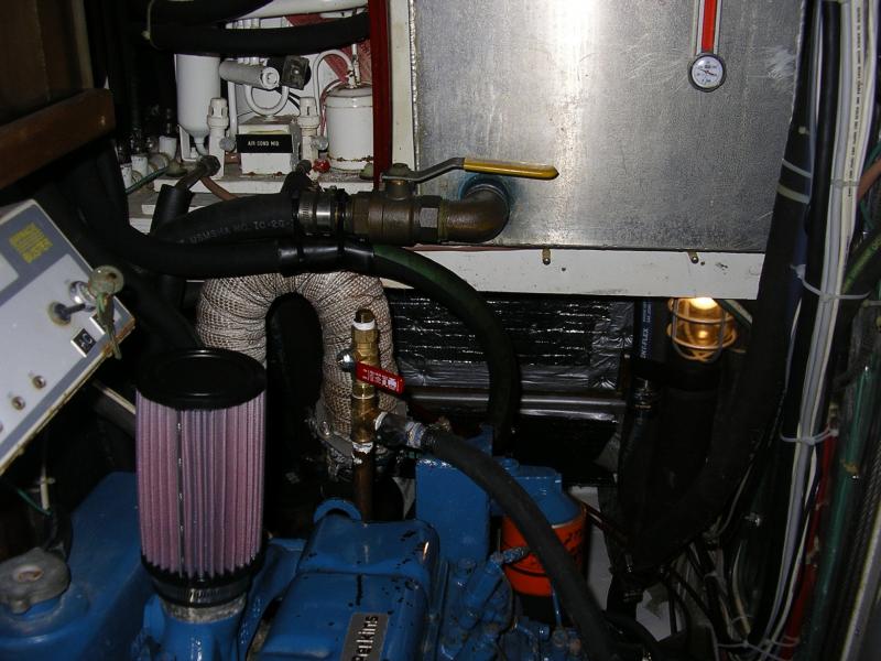

I just changed out the hot water tank and had to drain the lines of antifreeze. The PO had installed shutoff valves on the supply and return lines at the engine which made the draining a snap. The next step was having Maine Sail install a "T" with an additional valve that we would use to fill and burp the antifreeze. He added a short length of 1/2 inch tubing with a funnel that was held higher than the engine allowing it to fill the system. To keep the burping from splattering when we ran the engine, he held a towel over the funnel. We started the engine and as it warmed MS cracked the valve several times to release the expanding warm antifreeze into the tube. This was dumped into a bucket and repeated several times until we reached running temp. The valve was closed, the tubing and hose barb were removed, and a plug was tightened to the "T". :dance:
I remember my father running the car without a radiator cap until he could get it fixed, this was a spin on that same idea. I'll get a picture when we're back on the boat.
