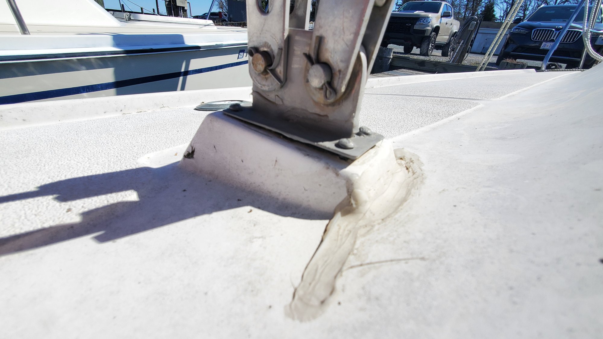

The port shroud was loose. I asked him if he saw a cover plate over the chain plate with four screws and said yes with no damage to interior bulkhead as well. I told to remove the screws removing the old caulk applying new caulk.

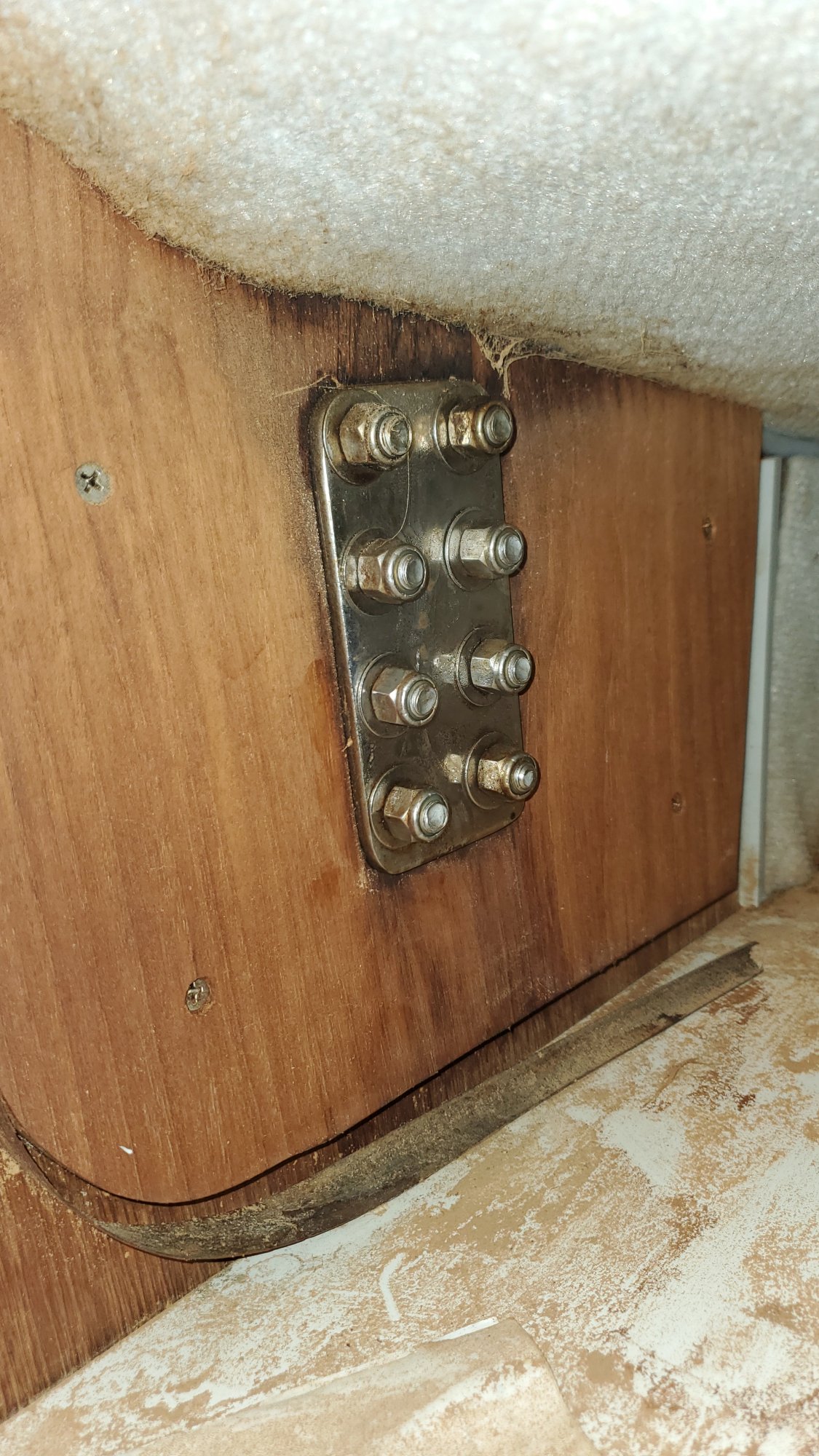

Thank you for the discussion crazy Dave. I'm attaching photos of the chain plate connection I mentioned in call, for reference. The chain plate on interior bulkhead appeared to be the only wet spot on the boat after it had rained.

Take a look at BedIT, especially for the chain plates. It will outlast the boat unlike most caulk like sealants.

make sure bulkhead is solid and bolts are tight. Get the leak fixed asap. Remove all caulk and recaulk.

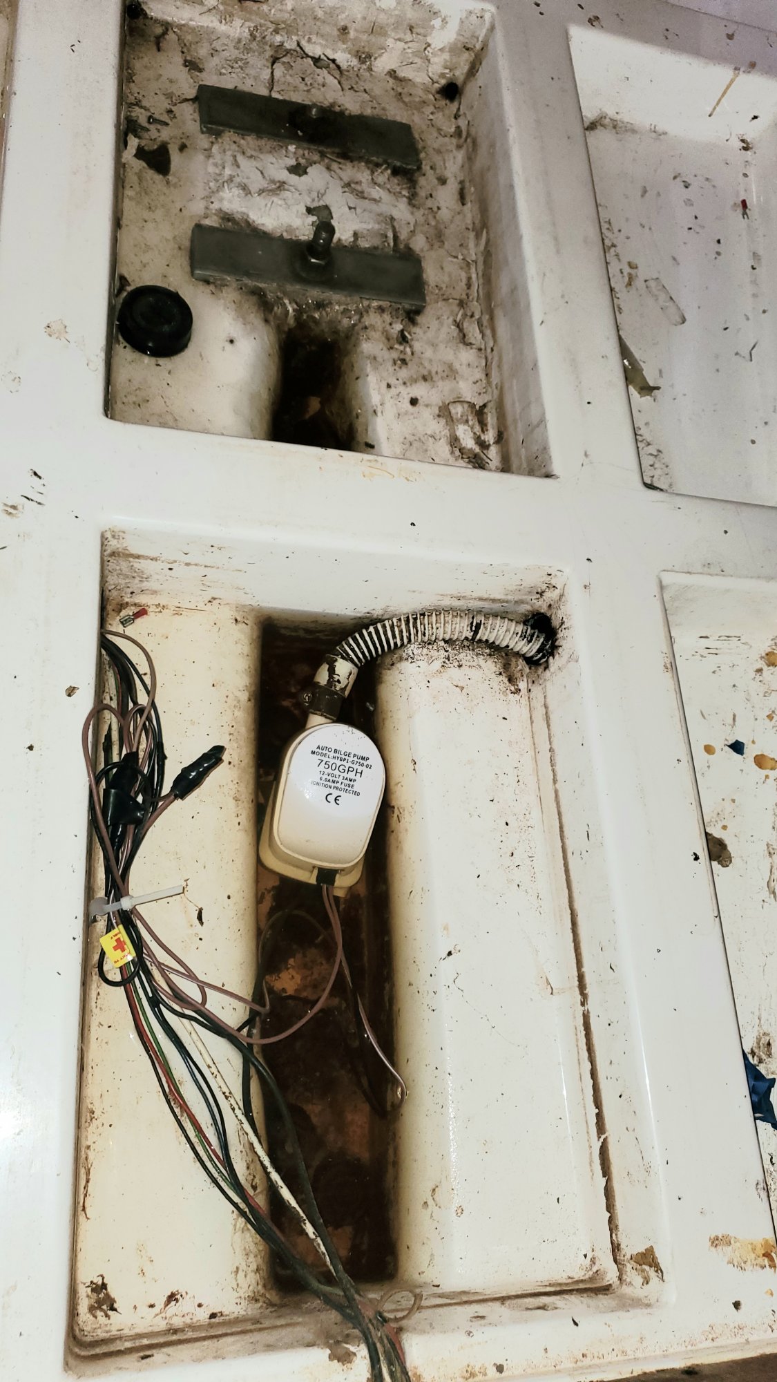

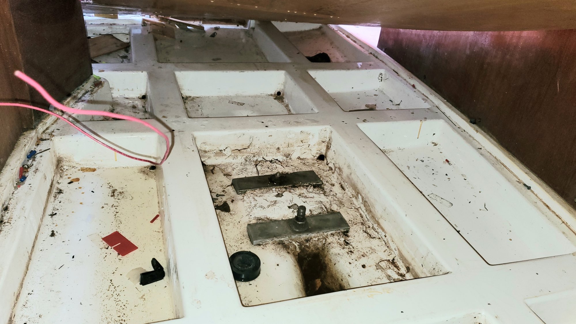

@Crazy Dave Condon , I was able to get under the floor today and did see some water in bilge. The other areas looked dry except the central compartment. Take a look at the attached photo. There are a couple leaks where rain water is getting into cabin but not sure this is from that or not. Is this a no go for you?

Spoke with @Bluebonnet87 today. Suspect rain water in bilge unless if salty; however, bottom last painted two years ago. I did tell him how to find deck leaks buy pressurizing cabin with a leaf blower with someone on deck with a brush using a brush to find air bubbling out. I told him to look under boat information for the H26.5 too. He is seriously considering making an offer on the boat
