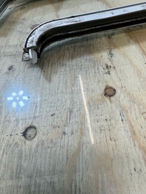

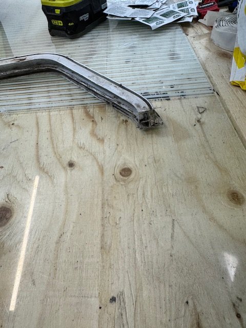

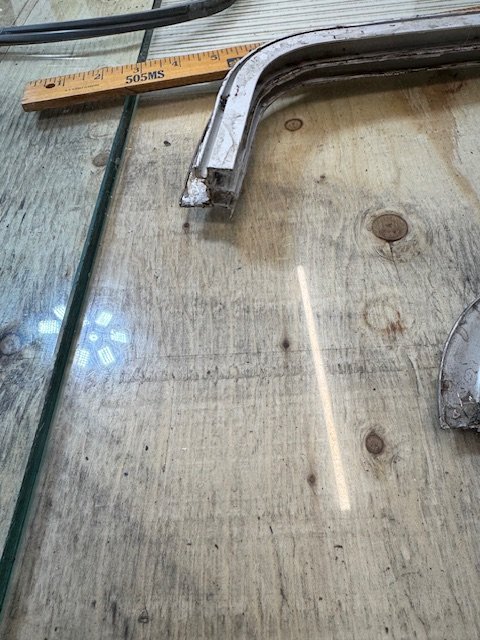

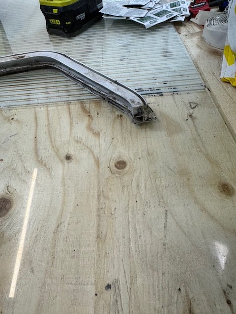

Working on a salon window, that took 2 days to remove from the boat because the PO installed it with 5200
And silicones the crap out of it to the frame, and of course it still leaked, managed to take it apart, need to scrape off the silicone, but how do I decontaminate it?
It will be sealed with butyl to the frame and again butyl to seal the frame to the boat

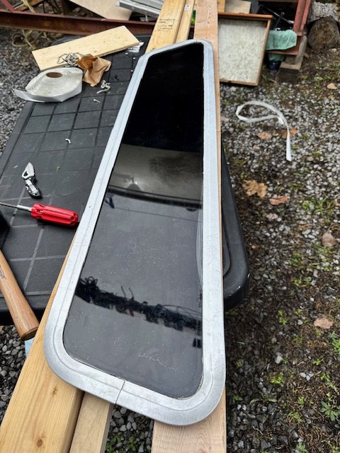

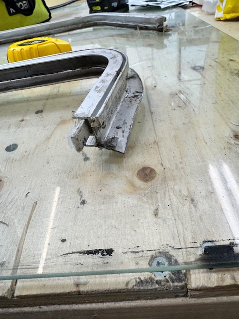

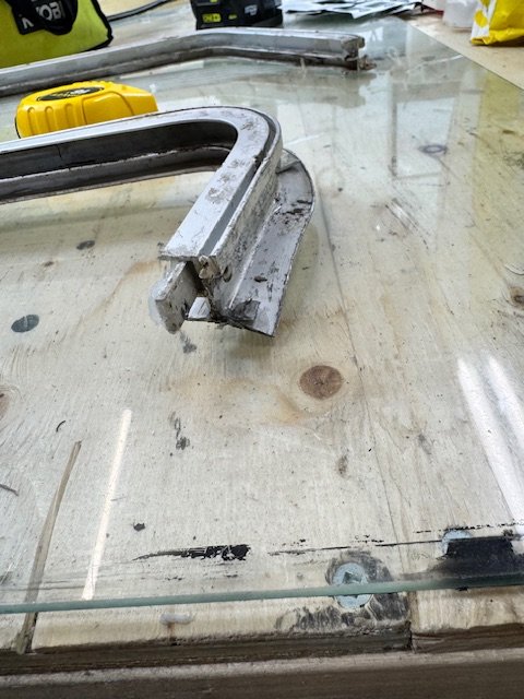

The frame is aluminium, the main frame is made of 2 parts, one upper and one lower, both have a channel to hold the glass in place, then there is a retaining ring that screws from the inside of the boat.
So the frame was held with 5200 and the window with silicone

There are 2 screws (4 really but 2 hold a piece that holds the frame parts together

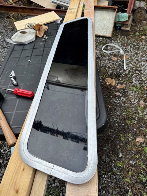

Well it took a lot of time and patience, but the window is back in one piece.
Going to install it after work today, weather permitting
