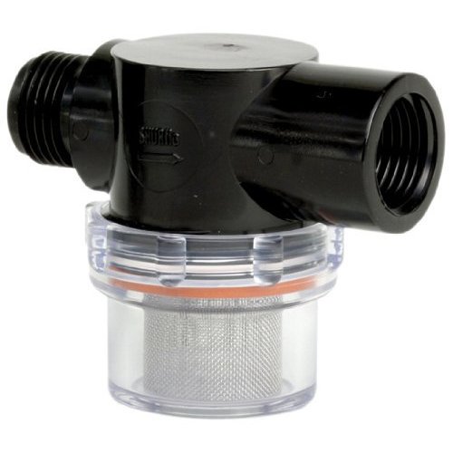

Hadn't thought about leaving it open during the off season. I may leave my cover off and lay some screen over it to keep the critters out. I followed Practical Sailor's advice and installed a filter on the vent side
Jul 5, 2011
754
Oday 28 Madison, CT
I have that type filter/strainer screwed onto my Shurflo fresh water pump. I keep an identical spare strainer on board so I can pull the dirty/blocked one and be back in business in a matter of seconds. Installing a port is also something i did, allowing me to get my hand in to scrub at least in the area where junk tends to collect and also to see what is going on in there.
