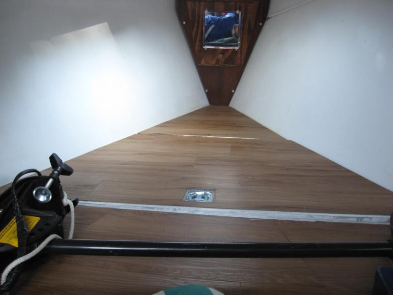

But what is the best way to attach these to the hull????
He had insulated and carpeted the hull, what would be the best way to glue the insulation on? Must be sheet foam insulation.
The first 2 pics are of the mag and how it looked, the last being my hull looking to the V berth. Now there's a storage area under the platform and a small storage area in front.

Hi Joe,
Some of the attachment points could be blocks of wood/plywood held to the hull with epoxy. Additional strength could be added by putting strips of fiberglass over the wood and out onto the hull. The West System six/ten is a nice consistancy that will not run as you attach the blocks of wood to the hull.

I had intended to add shelves at the settees by tabbing plywood shelves to the hull with FG tape and epoxy with the forward end screwed in the existing galley bulkhead and making a verticle support at the aft end which will attach by screwing into the overhead liner. I think I can get the hull profile byusing a piece of that blue insulation foam and marking the curve from outside the hull, at the toerail.

I thought about expoxy a piece to the hull, bit thought it might not stand the weight, if there was ant flexing.
