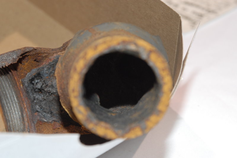

This fitting, a badly plugged and failed exhaust elbow, was done with Rectorseal, which is a 400F rating. No evidence of any threaded leaks and the female threads were still perfectly clean and rust free when the elbow disintegrated..
Mack Booring, the Yanmar distributor, does not even use or suggest a thread sealant on NPT/tapered pipe fittings. They suggest any "lubricant" used when putting them together can work quite well. This goes aginst conventional "piping wisdom" but apparently works..
Yanmar ships engines like this one with no sealant on the tapered pipe threads.
What ever pipe dope you use is better than the above photo even if it were to "off gas" in the rare situation that the temp exceeded 630F..

Wow, I never thought such a simple question would lead to such an involved response. Thanks for all the input. My parts are exactly as pictured below in the photo posted by Maine Sail. The threaded coupler that connects the exhaust elbow to the mixing elbow is the part in question.
The parts are all new (I replaced the entire exhaust system last year) ordered from my Yanmar dealer. I have no idea whether the part has NPT threads or SAE threads or XYZ threads, I just know they were made to screw together. When I assembled them, I went to my local Auto Zone store and bought a small bottle of high temperature anti-sieze compound. It's silvery in color and has a consistency similar to toothpaste. I don't know the brand offhand, as it's on the boat and I'm trapped in my office at the moment. I do believe it was a lithium based product. I don't know if I have an exhaust leak here or not, but I do usually have a mild exhaust smell in my aft cabin after I shut down the engine, so I'm going back and taking another look at what I did when I replaced the entire exhaust system. I questioned whether I did the right thing by using anti seize, and whether there should be something else used here instead. If Mack Boring ships these with no sealant or compound, then I guess that's good enough for me. I'll just go to Harbor Freight and buy a bigger wrench and get another half-turn on this connection and call it good. Again, thanks for all your input. Regards, Robert
