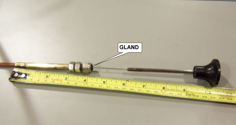

If they have a gland at the end with the control knob, keep that well lubed, otherwise don't add anything on the cable as the good ones are factory lubricated. I made the mistake of lubricating (used light grease) the one shown below and it became stiffer over the next few years until I had to replace it.

My cable is not like Ralph's.
