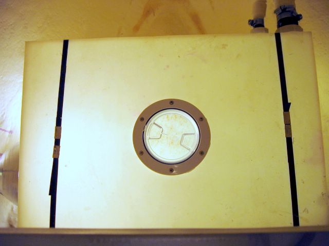

We're making this waaaaaaaaaaaaaay to complicated.
You use a zip router to cut the hole in the tank. Then you install the outer ring which is screwed to the tank. You need a gasket or caulk to keep the outer ring from leaking. The port itself has a gasket which is leakproof.
One picture shows the hole cut in the tank. The other shows the port installed.
Click on the picture to expand.
