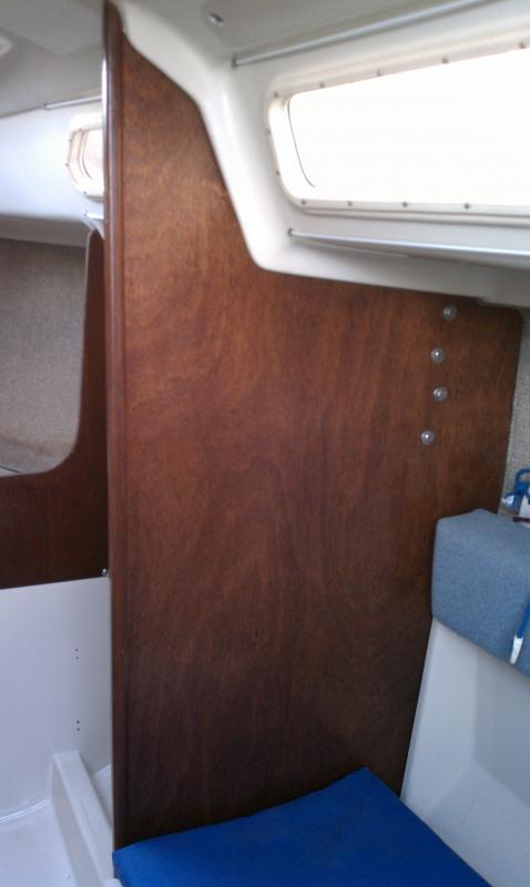

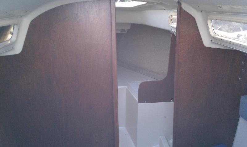

Installed new bulkheads in today. You can see one of the original ones in the background of the first picture. It was very orange, which is why we went a little darker with Minwax Red Oak. Everything came out and is now back in.
Aug 20, 2010
1,399
Oday 27 Oak Orchard
That looks fantastic. Your color matching to your other woodwork is nothing short of professional.
