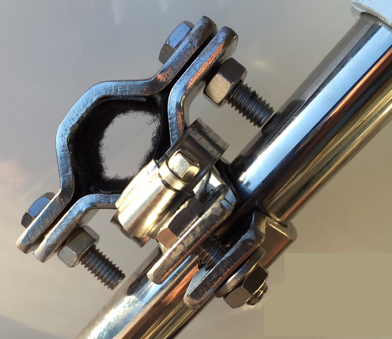

The "Rail-Flip" production has kept us so busy we have not produced a video of the "flip" process yet. We do have photos showing the "3-way" clamp adjustment system (up-down, pivot, & swing), which is uploaded here. The rail-flip procedure is quite easy...you just loosen the rack clamp lock, pivot the rack to the horizontal position and swing it around the stanchion until over the deck; then you pivot the rack support back to the vertical position & re-tighten the clamp lock. Takes about 20-30 seconds. Mounting this rack is just like any other rail rack..remove one of the nuts on a stanchion clamp, swing the clamp away, lay against the stanchion & swing the clamp back and secure (but first you will have rotated the stanchion clamp to the vertical position and locked it in place). Regarding lines, we have feedback that some folks mistakenly located their rack near a sheet fairlead so that when they flipped the rack over the deck, it interfered with the sheet. The solution was very simple...just slide the rack supports aft a couple feet, free of the sheet leads. Sailboatowners.com members will receive a 10% discount (remember to note your membership in the comments column when ordering).

Your products look great. I have been thinking about purchasing a Kayak for day exploration but was thinking about how to store it on board my Oday 35. The swing racks to the stanchions look like they will do the trick. I'll be ready to purchase once I get the Kayak. In the mean time, I would like to purchase the clamp that you are showing above to hold my davits for my dingy. I don't see it on your website. I will need the 7/8" to 1" version. I have not been able to find a clamp that will go from a stanchion to a stanchion in this way. If anyone knows of a source, I'm listening.

We couldn't find a source for this item that met our specs either! That's why we designed and built it ourselves. Most of the clamps like this (out there) are designed for light loads, such as antennas. The SR/LR universal-mount rack is brand new and the adjustable clamp is not even pictured in the catalog yet. But if you email us a photo of the stanchion where it will mount & the weight of your dingy, we can pull a set out of production for you. Just want to be sure that it will work for you first. We also use a welded (horizontal) rail-to-vertical stanchion clamp that doesn't need the pivot lock, and therefore is stronger than the pivoting version.

I'll get some pictures this weekend. Actually it will be a horizontal rail clamp going to a vertical tub on the davit.

Good! The horizontal rail-to-vertical stanchion clamp is welded and stronger than the adjustable clamp. We have a pair of these clamps set aside for you if you want them.
