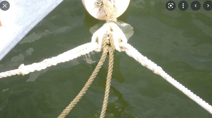

Hi thinwater! The plan is to secure the mooring lines as shown in the picture attached to eliminate chafe (line sawing) at the pennant itself and will also have line chafe guards on the boat side of the lines as well. The thought is to then also add a snubber/compensator on the primary lines for additional shock/load distribution and cleat longevity. We're new to the long term mooring life though - we have historically been kept at docks in protected harbors on the Great Lakes. Is snubber usage as I'm describing common on long term mooring balls? Thanks!

I've never found a snubber needed on a mooring ball - using nylon line along with all the "non-rigidity" of that system seemed sufficient.

Look around in your harbor at what everyone else is doing, and do that. :)
the nylon 3-strand mooring line is all the shock absorbing you will need. The only upgrade from there is a bridle, i.e., two mooring lines spliced into the line that leads down to the chain.

Agree with others…. All you need is a good mooring pendant. My boat has been through many storms out on our mooring with a 3/4 3 braid pendant. I made my own and use 2 separate lines with proper chafe protection.

A factor that makes a mooring different from a dock or even anchoring, is that when pulled hard, instead of snubbing hard, the float is pulled down a little, absorbing shock.
