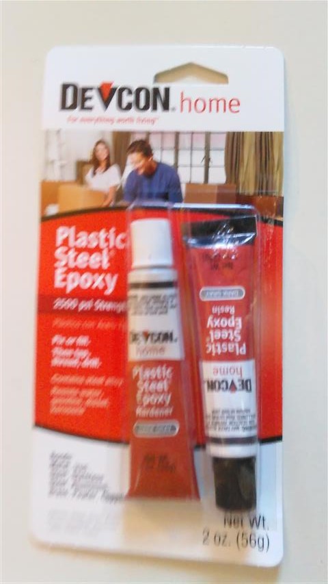

I had an issue with deterioration of aluminum around a ss bolt/stud for my raw water pump. JBWeld didn't do it. Devcon did. I've psted about this before, so a search should find it. Comes in small tubes for $14 or large tubs for $120.

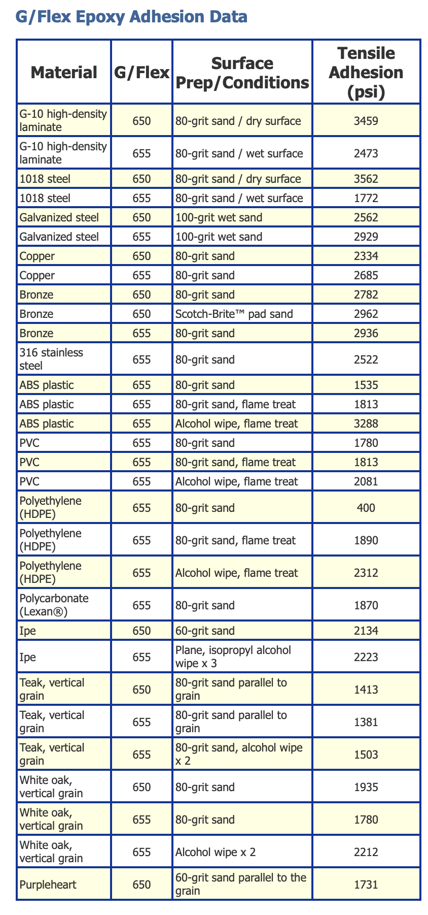

Yup. West G/Flex. Sand the metal first with 80 grit sandpaper. But aluminum forms an oxide layer very quickly. So sand the aluminum metal right before you apply the glue - or even put a thin layer of G/Flex on and sand it wet so oxygen can't reform any oxide. Then apply a bit more. Note that Gflex needs to dry 12 hours before you load it. GFlex 650 is liquid that you can thicken with any standard thickener like colodia silica. G/Flex 655 comes in a tube and is prethickened. G/Flex also works on most plastics.https://www.epoxyworks.com/index.php/aluminum-adhesion/ Aluminum Adhesion
