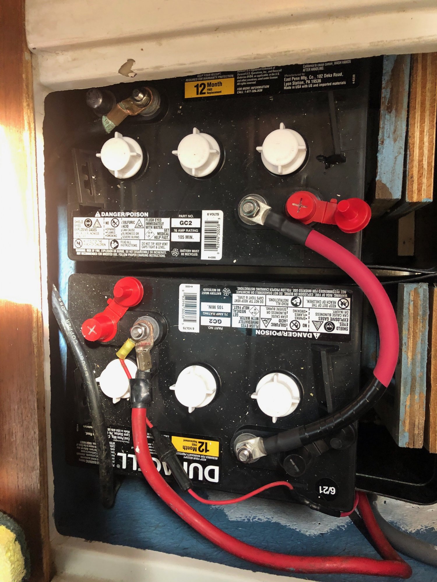

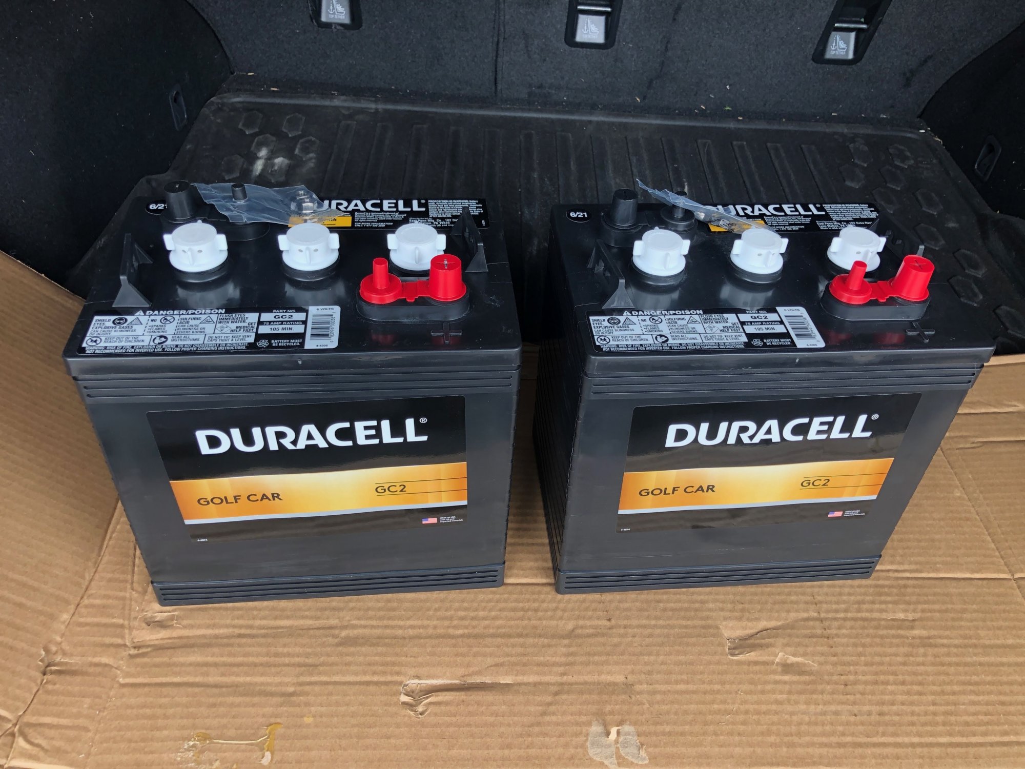

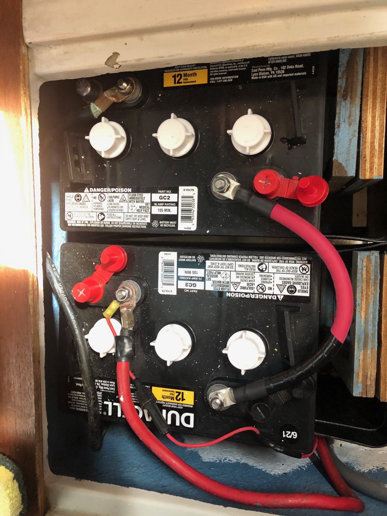

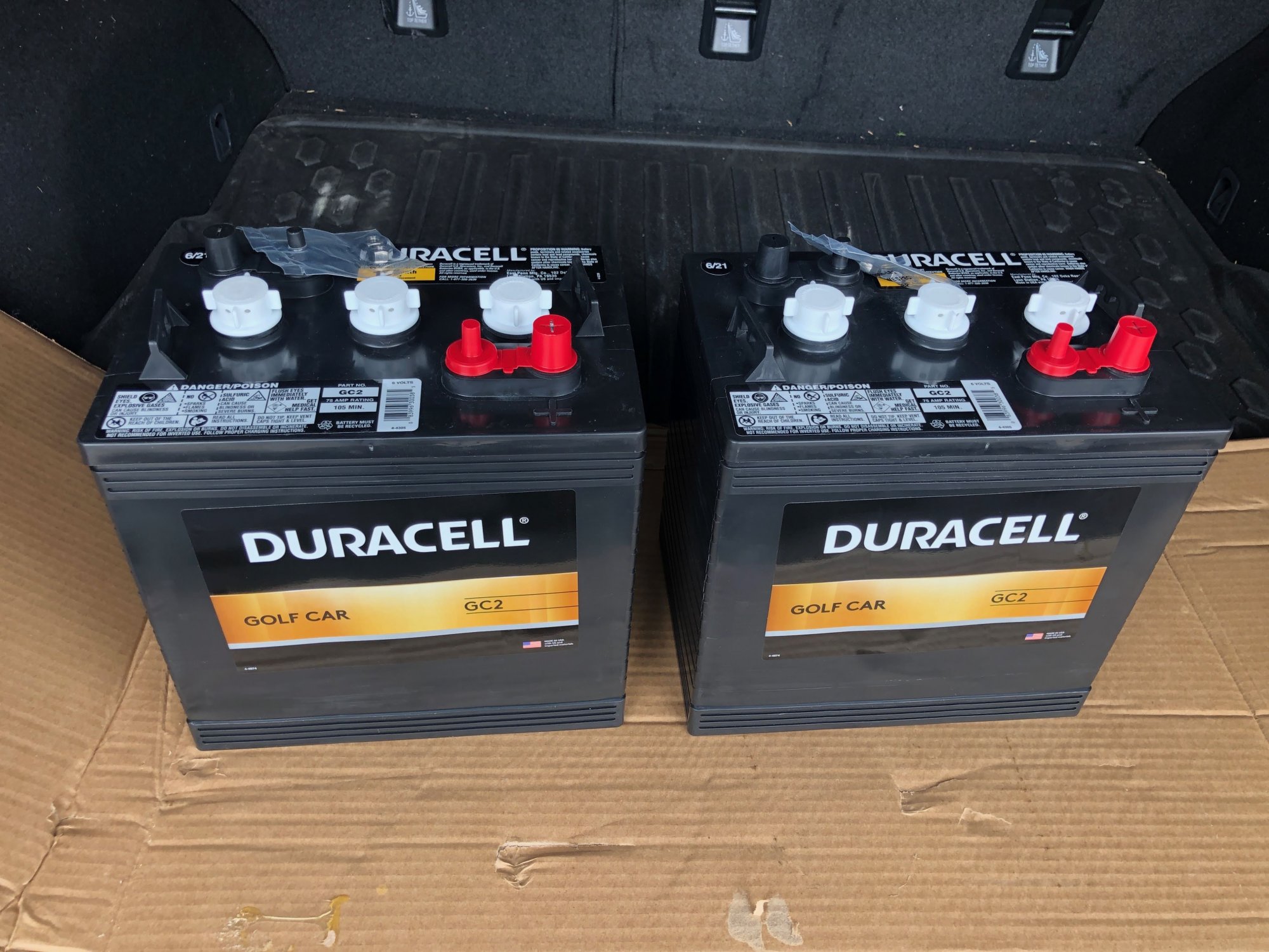

If you have the space and want the biggest $$ for your buck, I am a fan of 2 six-volt golf cart batteries.
B9AAB78A-3051-4A5B-8DF8-B1F688561A10.jpeg F887076A-2ABE-46A0-A6EF-AEEA483A534C.jpeg
I picked up 2 of these Duracell branded (Deka mfg) golf cart batteries at Sam’s Club a couple of years ago. 215 AH at 12 volts.
I don’t remember what I paid for them, but a bargain I think for the capacity, and no charging system upgrades required. About as bullet proof ans simple as it gets.
Greg
