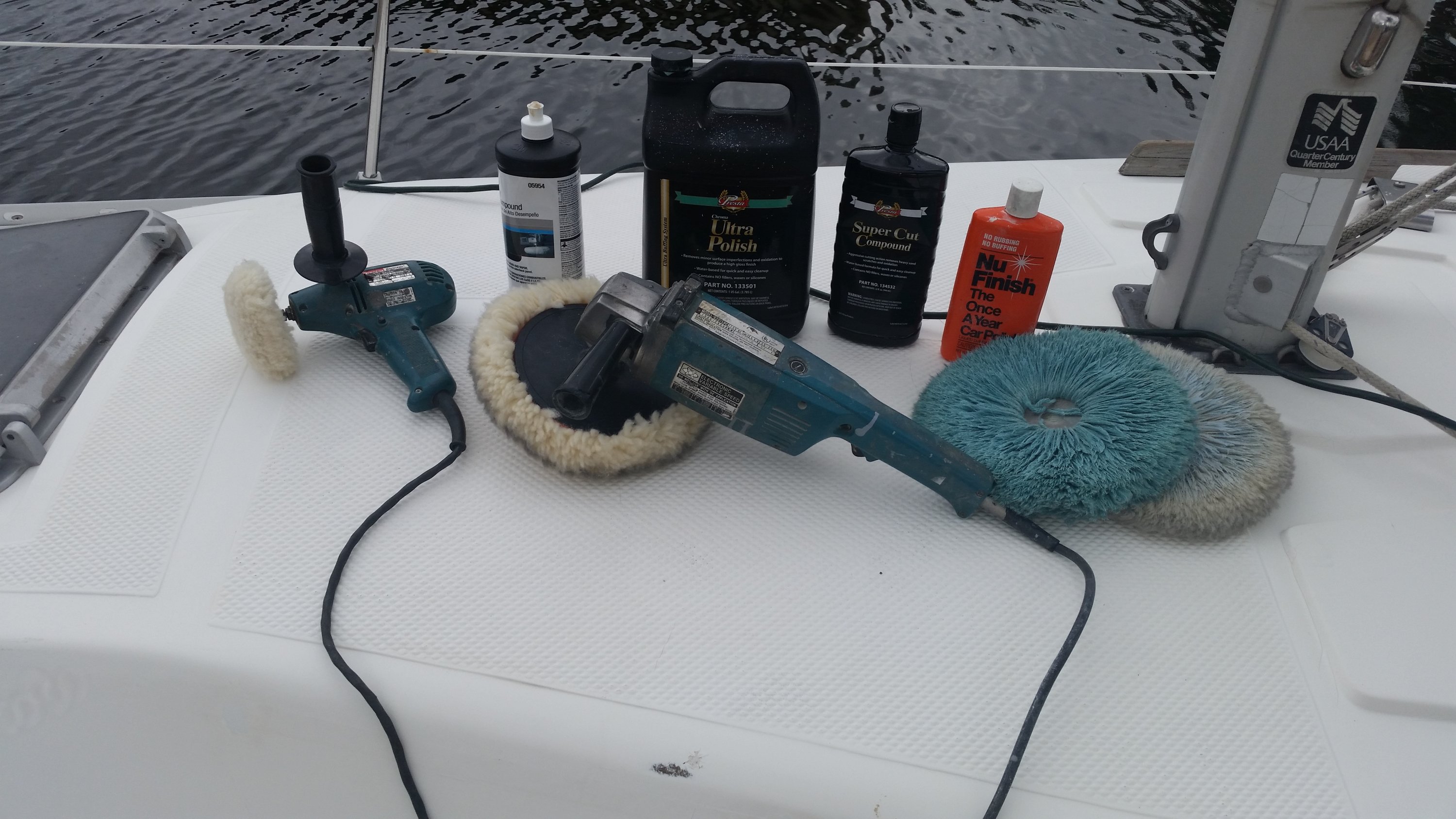

Realize, you don't have to buy them new. Both of my buffers were purchased used. The big Makita (9207SPC) from a pawn shop for $40, and the little one Makita (GV5000) from a yard sale for $5. It is great for tight spots where the larger one cant get to. I picked up another of the small ones at a pawn shop later for $10 so that I didn't have to keep switching pads out for the small areas I was using it for.
The new pads cost more than the tools lol.
Like many of us, I think, I've been very curious about a smaller buffer for all those tight spots. That looks like it might be just what I've been looking for!

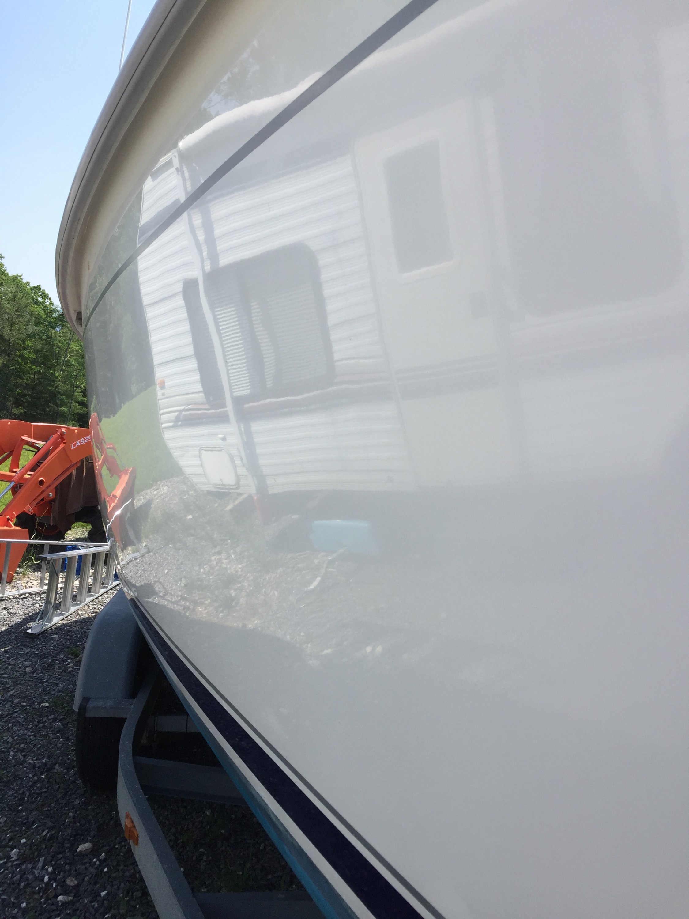

Briefly going thru the comments a few suggestions
1. Never go above 1000 rpm
2. Go back and forth never holding it in
one place for too long
3. Keep your pads clean
4. I used a cleaner wax after compounding
Followed by a second application of
Pure wax(uvb resistant of course)
Above photo is that of a Hunter 260 hull recently done by me
