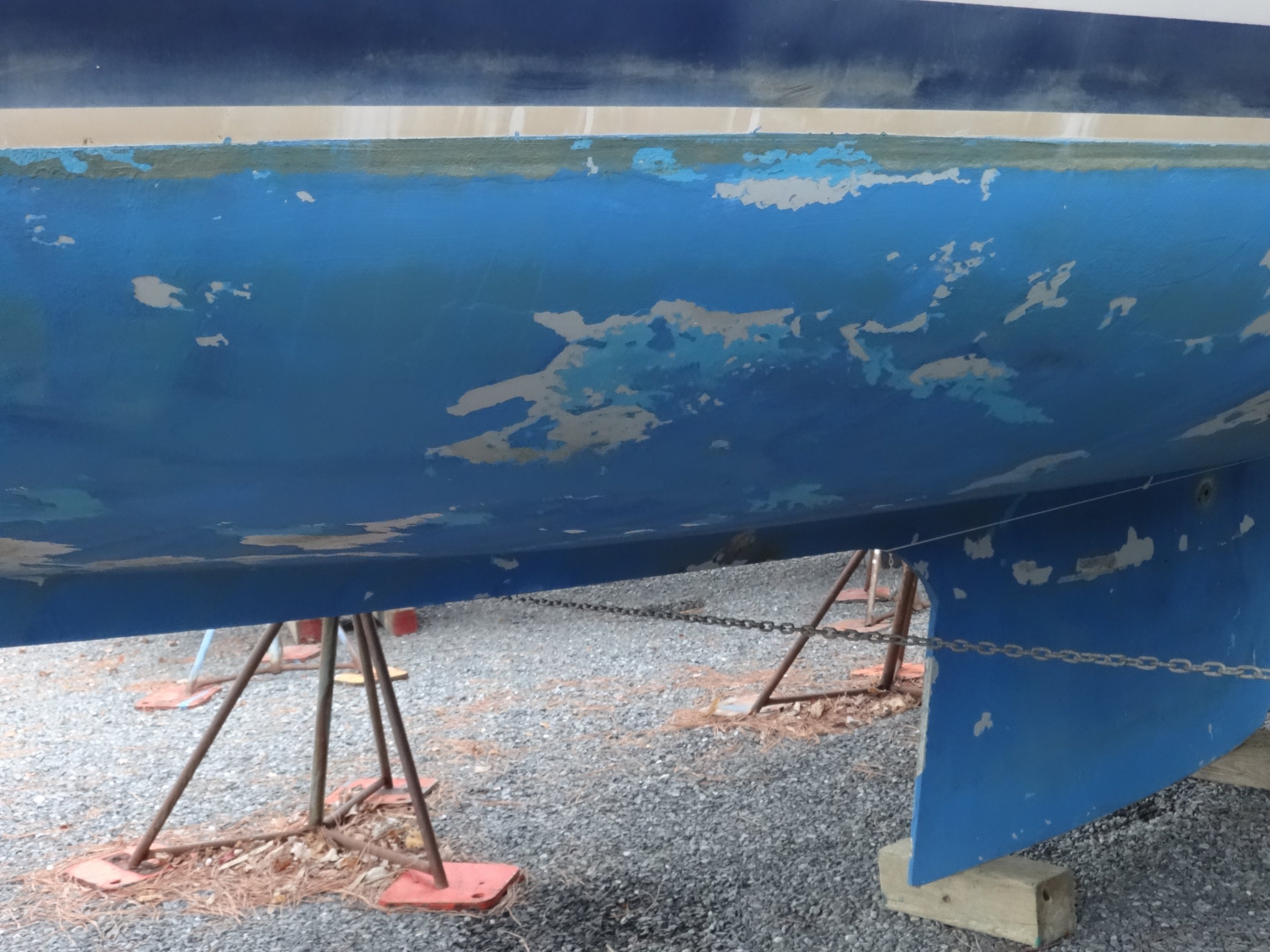

2016.JPG As you can see from the attached pic I have a lot of scraping to do. Went to the paint store and found a varied selection. Would a wide or narrow blade type push scraper or a pull type scraper work better?

Larry's photo makes it plain. This is no place for any scraper.
First, scrapers do not work unless kept razor sharp - means a file or sander in your back pocket thus to sharpen the scraper about every 10 passes. Second, the hull is quite curved and your scraper is quite straight. In other words scrapers are good for flat house siding but not very good for curvy boats.
Use 40 - 60 grit 3M on a 6" random orbital with an interface (soft) pad which will conform to the curve of the boat - and you will be done before you know it - about 3 hours for a 30' boat. There are places your sanding machine cannot get into and it is at those places a scraper is useful.
All things considered the scraper overall approach will get you paint ready sometime around next October but you will still have to sand to get it paint ready after scraping anyhow.

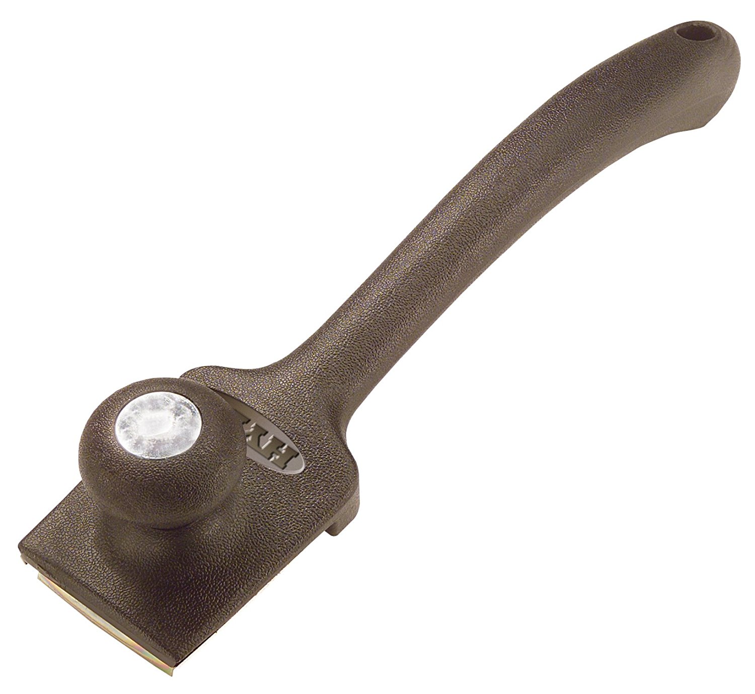

Our 34 had 23 years of ablative bottom paint and VC Tar barrier coat when I scraped the bottom in 2006. I used 2" wide "u" shaped pull scrapers. I kept an orbital sander and a file close by and sharpened the scraper periodically. Replacement blades are cheap, I bought a few extras. I used the steel blades that were a square with four cutting edges. Rounding the edges of the scraper blades slightly is paramount - they will dig into the gelcoat on those strokes that don't go exactly as intended! I also purchased a carbide scraper toward the end, but I think the thinner edge of the u shaped scraper was more effective. I did my bottom over a winter layup, so most of the days I worked on it were probably between 25 and 40 degrees. I don't know if it was this or the age, but the VC Tar came off pretty well - it was more brittle than gooey. The trick it seemed was to get the edge to bite all the way under the paint and tar, then pull - usually I could get a good 2" swath all the way down to gel coat in one stroke. I tried to do 2' square sections - it seemed easier to get all the way down to gelcoat in one stroke if the strokes were shorter rather than longer. If the scraper happened to ride up onto the surface of the paint it seemed to burnish the tar barrier it making it harder to scrape off. It was a daunting, tedious job, and after I had everything scraped I went over it with a random orbit sander, and some mineral spirits on a rag to remove any remaining tar. I barrier coated with 7 coats of Interprotect 2000 after the bottom was all clean. Let me know if you have any other questions.
This is the scraper I used - guess it was actually 2 1/2":

I've used both pull and push type.... the pull makes me nervous... the push feels more under control. A very stiff scraper such as the one lake shark pictured is my choice. I don't want it super razor sharp because it could cut the gel.... rather than just getting between it and the old paint. If that type off scraper can't release the paint... then hand sanding proceeds. Hand and/or wet sanding will satisfy most environmental restrictions, if you're in a yard.
