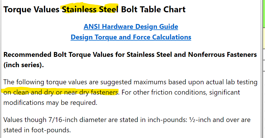

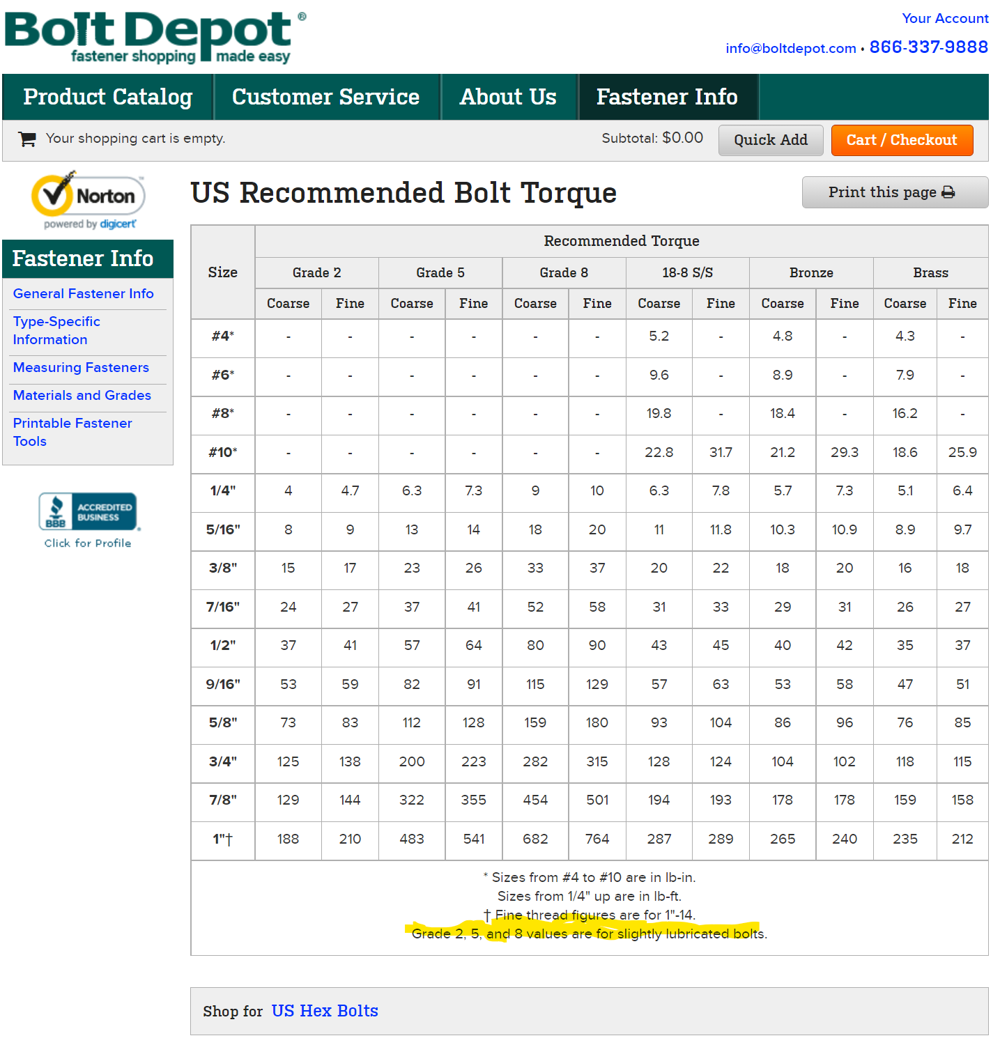

Specifically I am thinking of applying it to windlass mounting bolts as well as outboard bottom end bolts (including the prop nut). I want something that won't make the bolts tend to come off either (would I need to adjust my torque settings when using anti-seize?), as this would be inconvenient when weighing anchor or motoring my family to shore in our dinghy.
Technically yes. Torque specs assume a dry fit.
In practical applications.. It depends on the fastener and torque specs. Very small fine thread fasteners can be easily damaged so the tightening tolerance is narrow before you damage threads.
Cylinder head bolts should always be done 100% to spec... With no anti seize.
