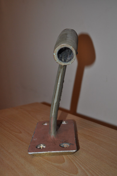

Bent strut
Sep 25, 2012
57
Hunter 30 Massena, NY
Well we got the strut removed from the boat and now it goes to the shop to get straightened. I've read conflicting messages as to how to go about aligning, someone said a laser light an other said to align while she sits in the water. I will be replacing the four bolts and reinstalling the washers used as spacers between the hull and strut then 5200 around the strut base.
Jan 21, 2009
260
Catalina 30 Lake Perry, KS
Aligin while the boat is in the water. Let it settle a few days first. I don't understand the fascination with 5200. It is an adhesive and should not be used as caulk. I would recommend another product.
Sep 25, 2012
57
Good to know, the machine shop gets it today so I'll have results soon.
