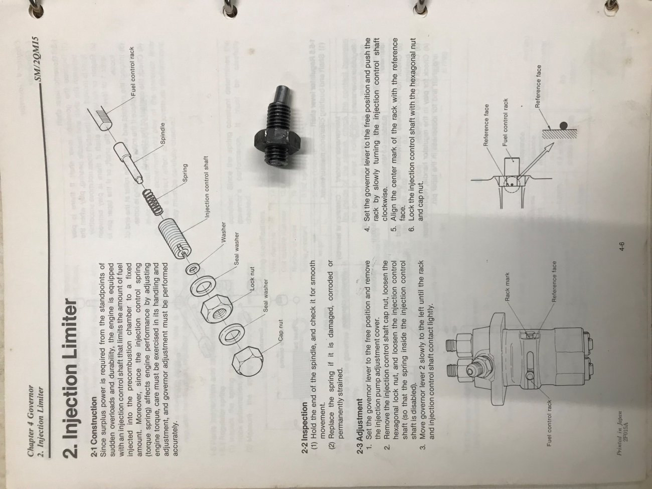

I'm considering purchasing a 79 Hunter that has a 2QM15 Yanmar engine. That engine is not currently running as the fuel Injection Limiter has bent as in the photo below. Has anybody see this before and if so what was the cause?

Perhaps someone with a hammer was upset with the limits being placed on their fun...
Is it important to know how it happened or to know how to fix it?

I'm actually fine with the hammer explanation. I'd prefer that to the unknown. The fix is rather trivial, but since I'd be buying a boat with an old engine that was apparently overstressed in at least one way, it makes me wonder if the same event damaged other parts with imminent failure lurking. In other words its a price thing.

Dunno, I don't see a way to bend it except in a bad disassembly/assembly.. I don't know how or if enough force could be applied to the linkage through the governor to be able to bend the stop ..?? check to see if the rack and linkage moves freely.. if it does, should be good.. if it feels sticky or draggy, it may have been damaged by someone screwing the stop in too far.. or by removing the linkage or pump without removing the stop .. most likely cause of damage.. Seems like the gear case cover might have to be off in order to damage that stop??
My limited knowledge of the QM is that if the crankcase vent gets plugged, they are prone to runaway.. someone may have screwed in the stop forcefully after having a runaway and not diagnosing the problem correctly.. Because the dipstick tube enters the oil pan below the oil level on that engine, a plugged crankcase vent will normally blow liquid oil out of the tube and make a real mess.. it is a lot worse if the piston rings are past their service life..

I had the same thoughts as everything you said in the first paragraph. It seems like a relatively protected part that shouldn't have extreme force on it.
I didn't know about the vent issue so I'll have to keep that in mind.

that is precisely the issue about the limiter spindle being bent. I haven't heard the engine run and apparently the mechanic hasn't found a replacement part, so maybe it needs to be machined. Consequently it is unclear when the engine will be running.

I'm just waiting for them to fix it. Spoke with the yard and they don't have any estimate as to when they'll have it back together as they can't find the part new or used. Apparently Yanmar hasn't had it available for "the last 15 years". The yard does have it's own machine shop and said that would be the last resort. Seems like they must be close making that decision.
