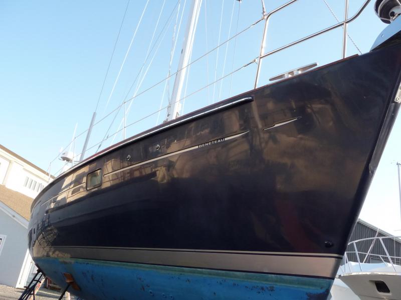

Rub rail - installed. If you search the board you will find a previous post where I included material and suppliers.

Maybe it's the angel of the picture, but it looks like the hull prtrudes more than the rubrail? It that your boat?

My boat. It is the angle of the photo. The rubrail is 1.75" and has a .250" SS strike. When planning this install, that extended rubrail seemed too big, but as you can see, once installed it looks proportional.
We now slide down the piles without a worry!
