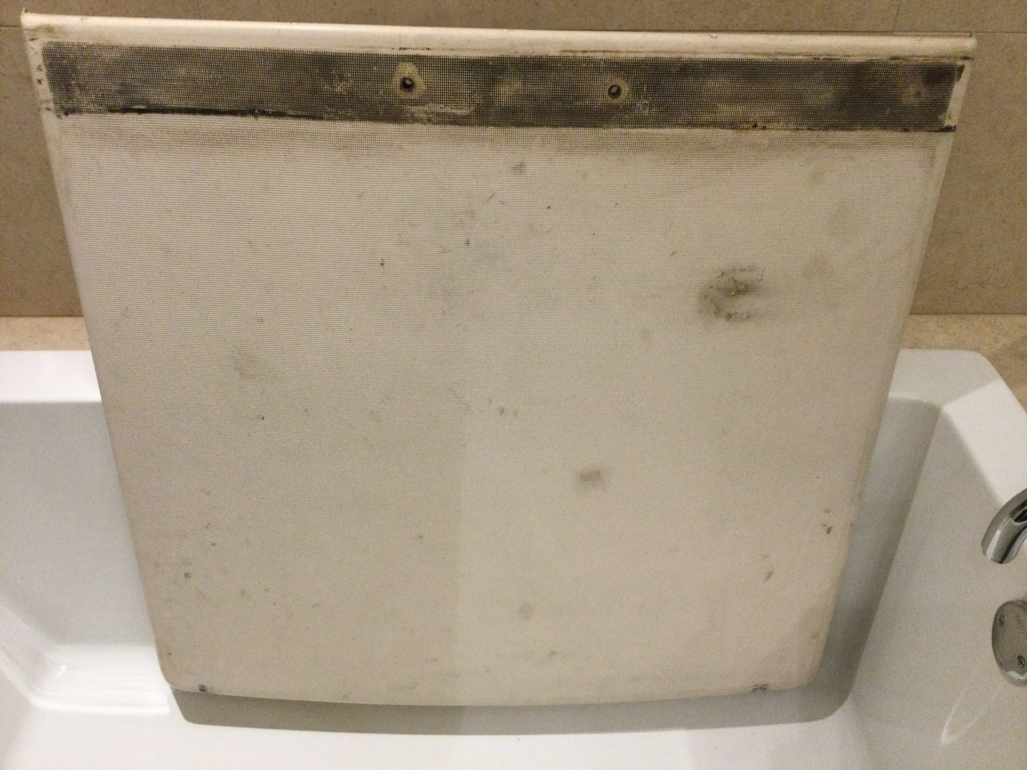

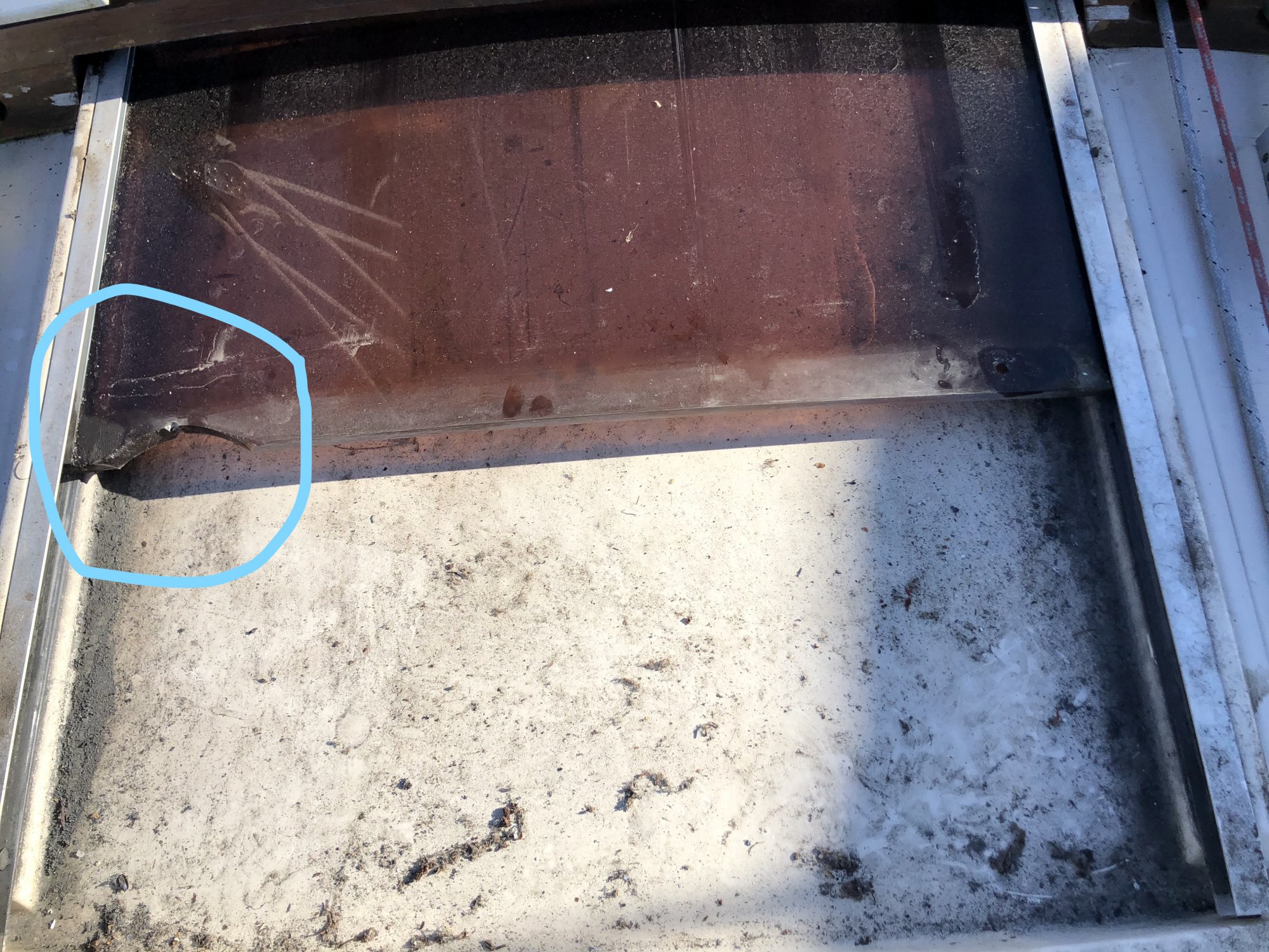

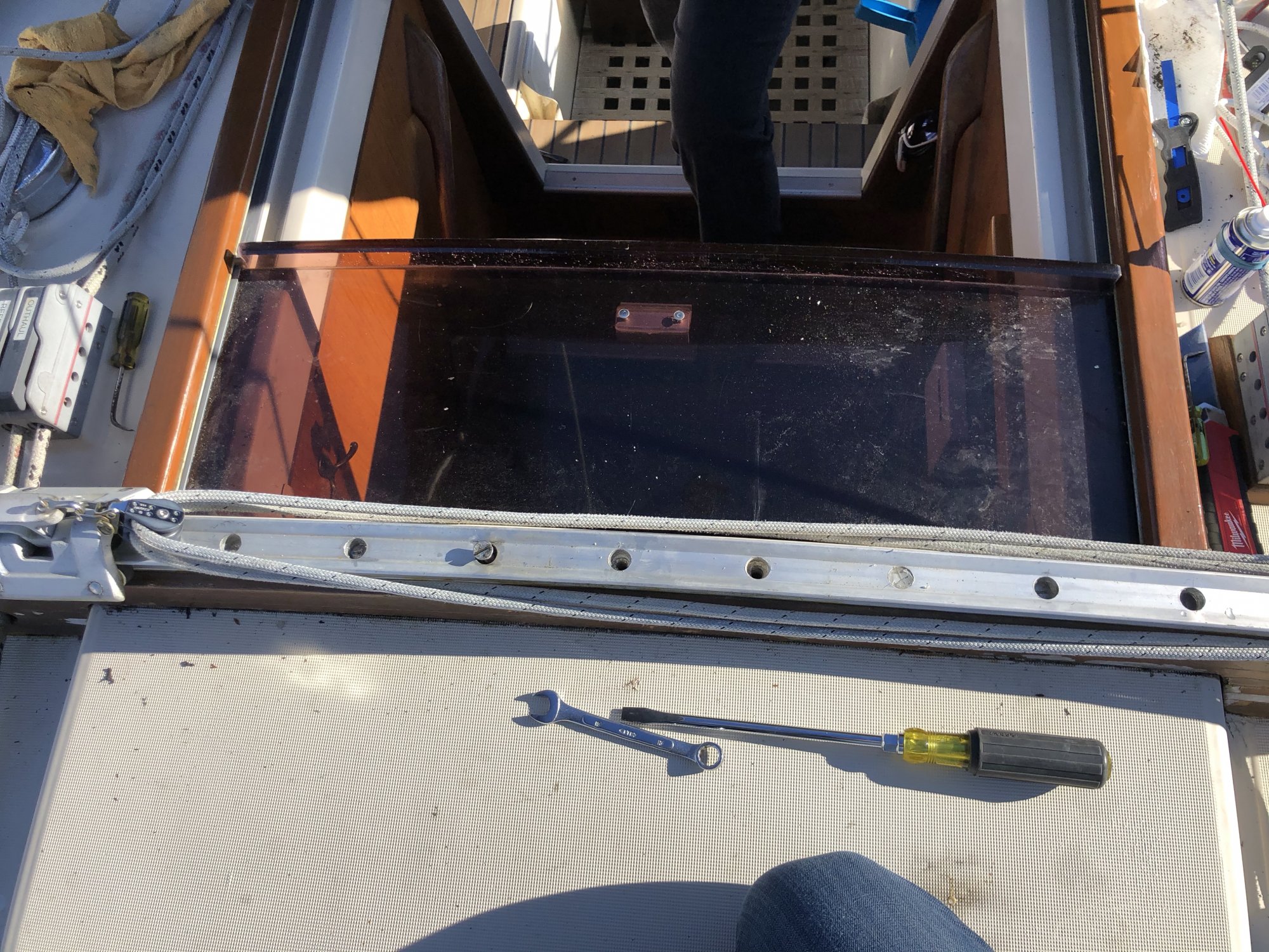

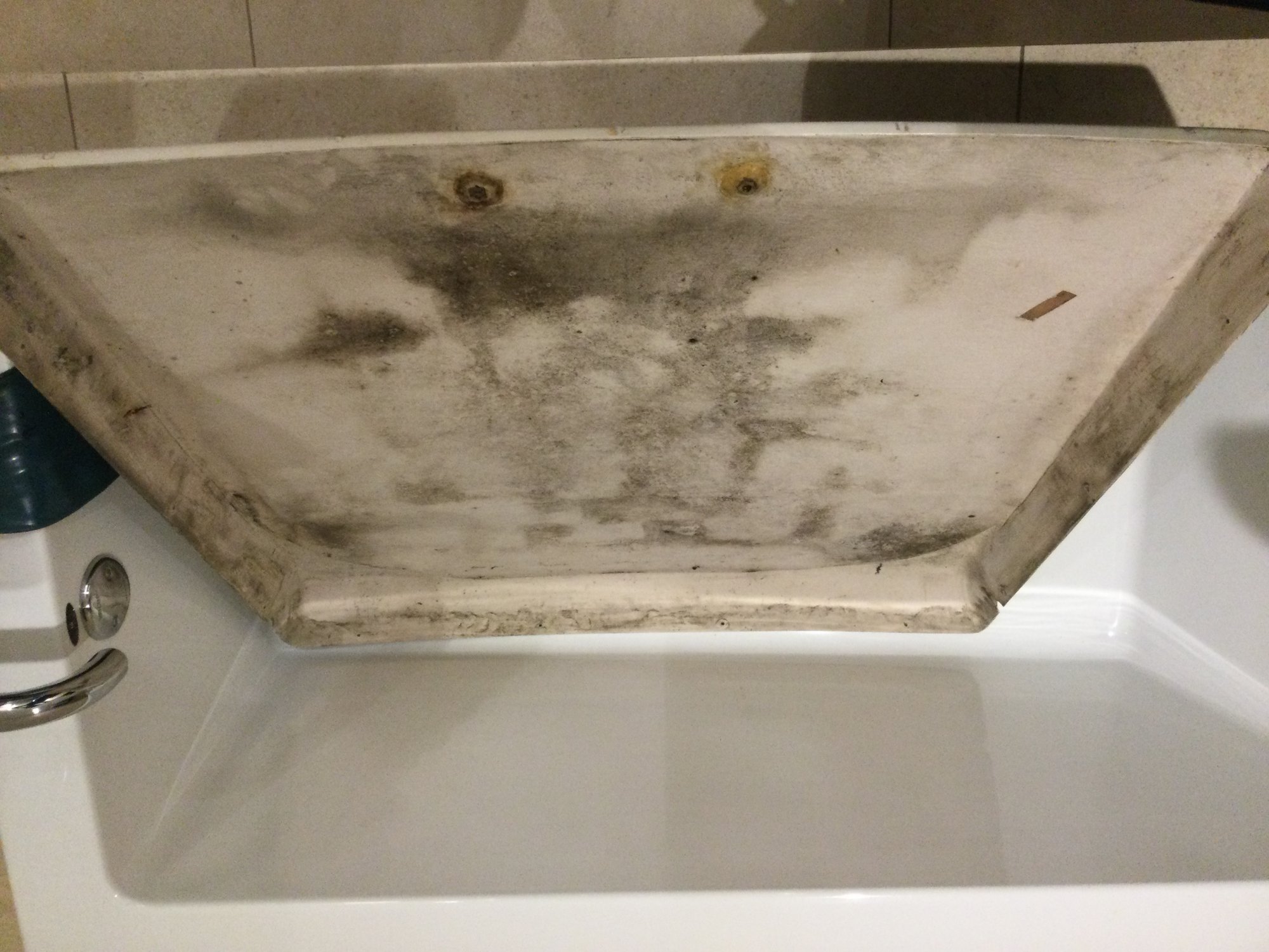

Update - we removed the garage cover (the cover that the companionway slides into when open). Two of the bolts that fasten the traveler track and block to the deck extend through the cover so must be removed before the cover can slide forward and away from underneath the traveler block. We found two bolts did not have nuts! We found one nut lying on top of the companion way cover but didn't find the other. At this point we haven't decided if we will remove the teak block or traveler track. We have asked the wood expert from our local boat yard to evaluate the integrity of the teak block. If there's significant rot we will remove it. We also discovered the companionway cover had broken near the starboard stop. Hopefully we will be able to repair this.
The attached pictures show:
1. the companionway cover with the STB stop piece broken away from the cover
2. a top down view of the traveler, garage and companionway before removing the covers
3. the garage cover removed showing the under side with the two embedded nuts for the two bolts that extend from the traveler track through to the garage cover.
4. the top view of the garage cover (before cleaning). The two bolt holes are visible near the centre.
