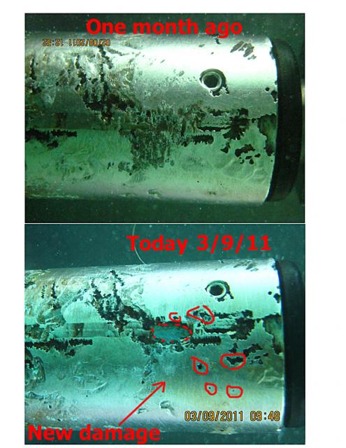

I'm a relatively new owner of a 1999 Beneteau 321 which we keep in San Diego. In January the boatyard installed a new cutlass bearing, flexofold propeller and zinc on the prop shaft. The diver who cleans the bottom monthly advises me that the stainless steel? tube in which the cutlass bearing is mounted is actively corroding. See attached picture.
When I look inside the boat, I see no metal fitting on which to attach a bonding wire. Somewhere in the fiberglass skeg, the metal tube housing the cutlass bearing transitions to a fiberglass/epoxy tube. There is a dripless Volvo shaft seal. So if something is to be done to stop the corrosion, it appears it has to be done outside the boat.
The diver is going to attempt to install a small zinc using one of the setscrews that retain the cutlass bearing. There are extra setscrews added by a previous owner. Does this seem right? Have others had this problem? Is this galvanic corrosion or crevice corrosion? Is this a flaw in the design? Am I missing something?
