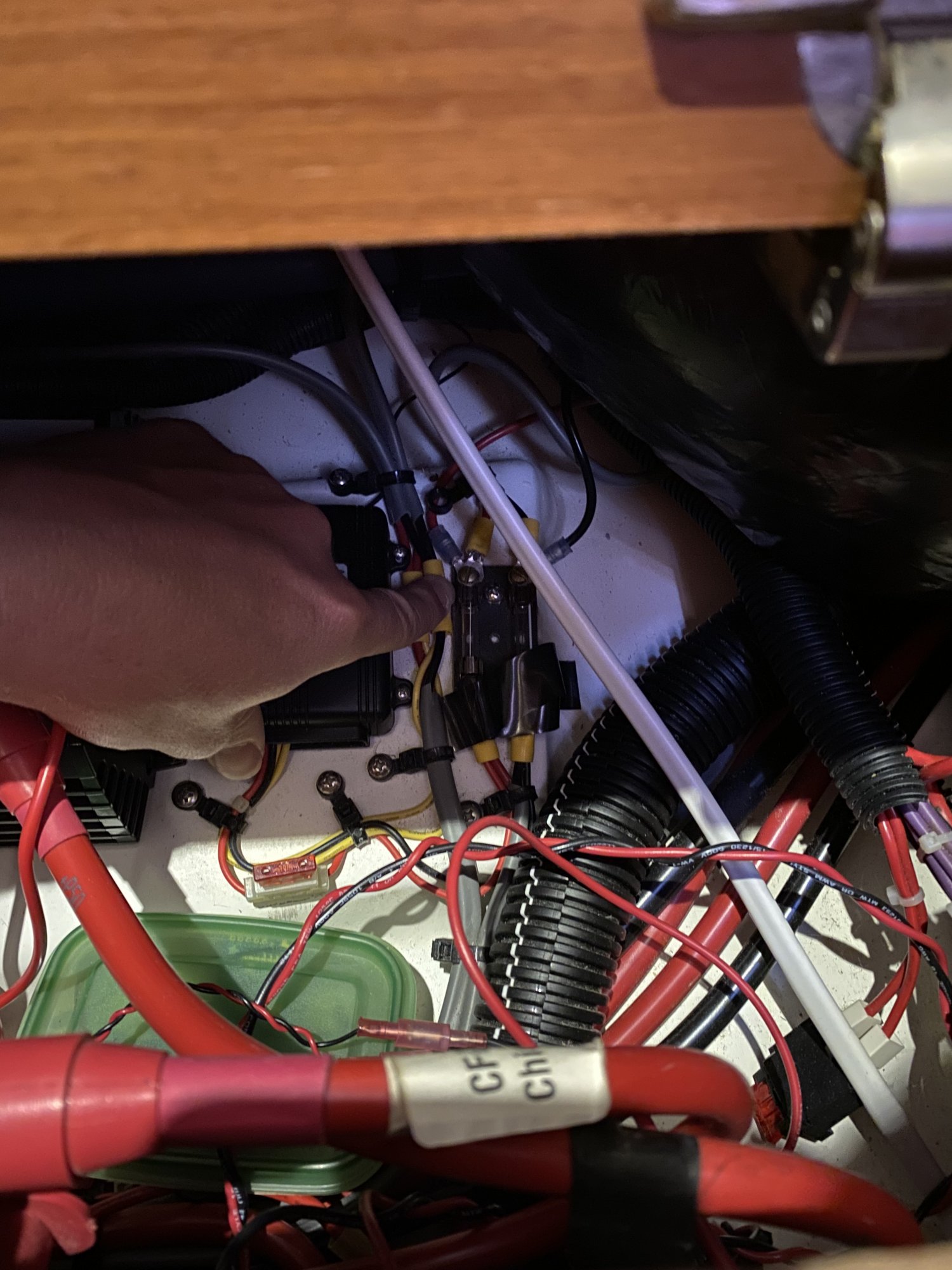

5,673
I looked at how mine are wired today. Unfortunately it’s still not really clear to me how it’s supposed to work.
The yellow wires definitely connect to both the red and black.The wires from the top of the connectors seem to go to the LEDs. The wires going into the bottom of the connector go into a bundle that heads toward the battery switches. But that doesn’t make much sense, because it would suggest the lights are always powered. No part of the terminals were really exposed enough for me to touch with a DVM.

I would tear everything out and rewire that rat’s nest! It doesn‘t look like proper color coding was followed, who knows. Whoever wired it may have used whatever color was handy.
5,673
Except for one pair of red/black that I’ve added (and moved from its bundle while I was digging) it’s all factory. Maybe the picture makes it look worse than it is. Everything is red/black, and proper polarity, except for the two yellow wires from the AquaSignal device.
