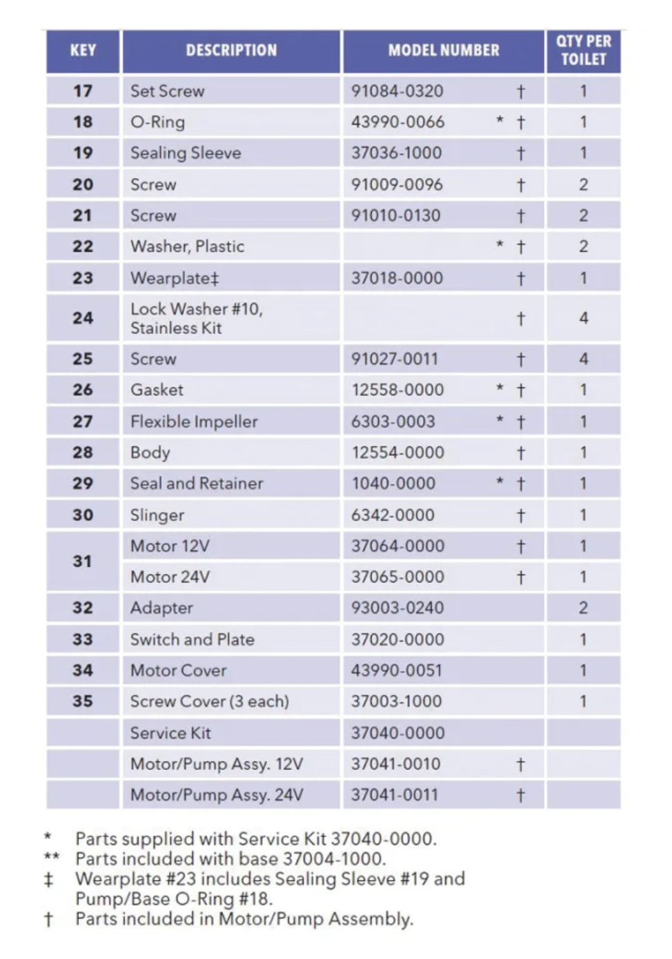

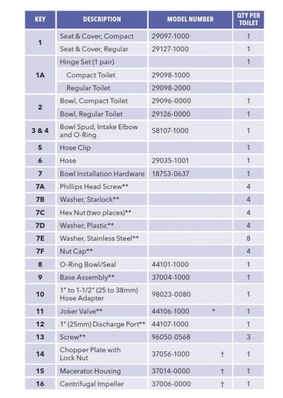

Jabsco makes the Electric 37010 Series and the Quiet Flush.
They only show one Joker valve at the toilet, part # 11. As far as I can tell, that is the same for both models.
If a second joker valve was installed, that is likely a PO modification. Being further away from the Head Pump, effluent materials could get stuck in the second valve and contribute to a failure (conjecture).
