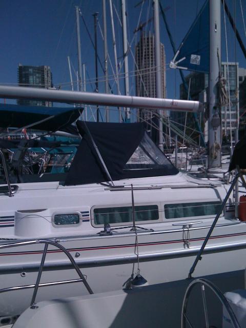

Hi. Thanks for your input. Sorry I took so long to reply. Here is a pic of my new dodger.
