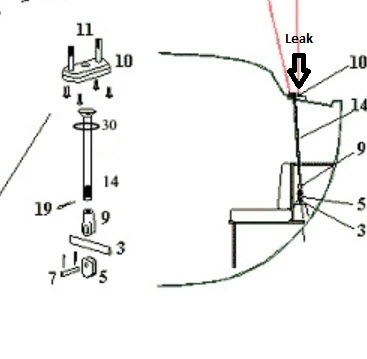

Just hazarding a guess here from looking at the pictures. The stains are both located in the same location as the mast stays penetration. I might say the leaks are there and not at the toe rail joints. It's hard to diagnose from just pictures.
Good Luck
Just another thought, it could be through the stanchion connection which I believe is also in the same location on both sides.

+1 with Joker's post,
it took me 3 tries to get my struts to stop leaking. The water staining on your hull is likely rain water that came in around the strut and travels when the boat heals over. I would order new panels becasue there is no way to fix the teak vener.
To stop the leak, take it apart buy moving your shrouds to the toerail, then unscrew the strut from inside counting the number of turns, then push it out the top then unbolt the cap from below. Use butyl rubber (from Maine Sail on this forum), and make yourself an aluminum cap to cover the top of the rod. After you cleaned up the silicone, make a butyl ball in your hand, make a large doughnut out of it, place the dounghnut on the deck side of the cap. Place the cap into postion, bolt down from the inside. Now insert the rod from above through the large hole in the cap/butyl/deck, and down to the threaded turnbuckle. the same number of turns you counded to remove it, then reinstall cotter pins, and now shrouds. Now install the new cap above the rod with a small bit of sikaflex. Do not use silicone, it will leak and is a bugger to clean up.
