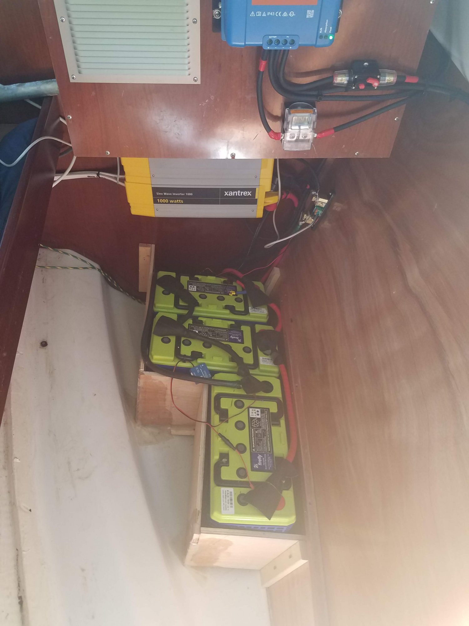

I just finished moving my house batteries. I put three carbon foam 12 volts under the floor of the sail locker. It's going to load the boat on the port side, but will ballance with other crap on Starboard. Very happy with the space there.

The floor of your sail locker must be a lot deeper than mine. Checked today and there's less than a foot of space under there. There is a lot of room in the sail locker to install all the electronics and store batteries.

Looks about the same as mine. I will have to raise the floor a couple inches. I am hoping to finish this install tomorrow. I will post pictures when done.
Its tight, and they dont set upright, they lean a little but since they are carbon foam, they should be happy there. I will add some vent holes.

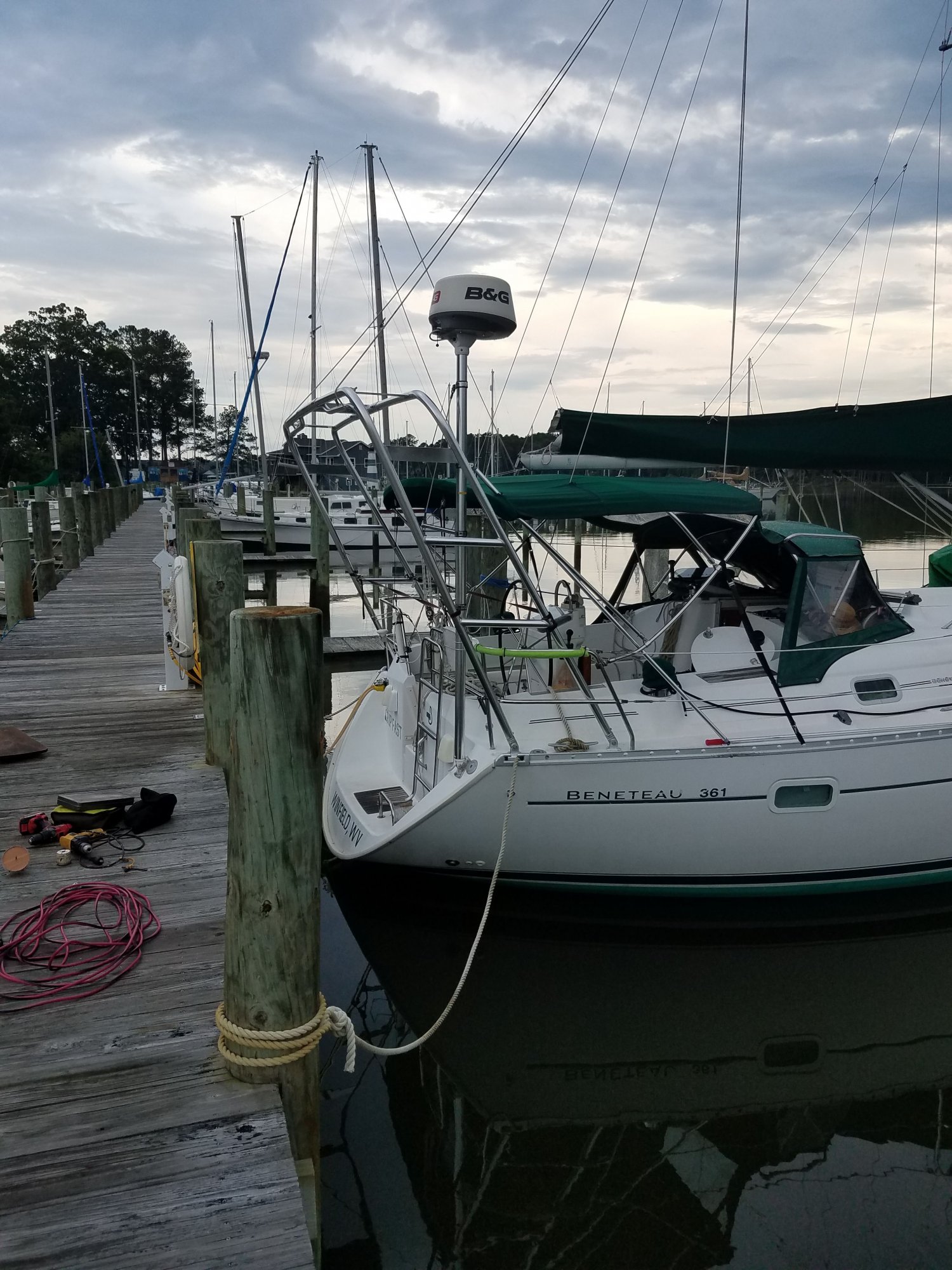

have 4, 110 watt panels that I mounted on an arch. I bought one of those "tower in a box" arches. it looks pretty good. it was a pretty slow install. did it a few weeks ago in crazy heat. I will figure out how to post pictures on this site and post some pictures in a few days.
Jul 1, 2020
14
Beneteau 361 Lancaster, VA
I had to raise the floor 2 1/5 inches to cover the batteries. I just screwed strips of wood to the sides of the plywood floor to get the height I needed. The arch is shown in the other picture. I will take one of with the pannels after it quites raining if you want to see how they are mounted.

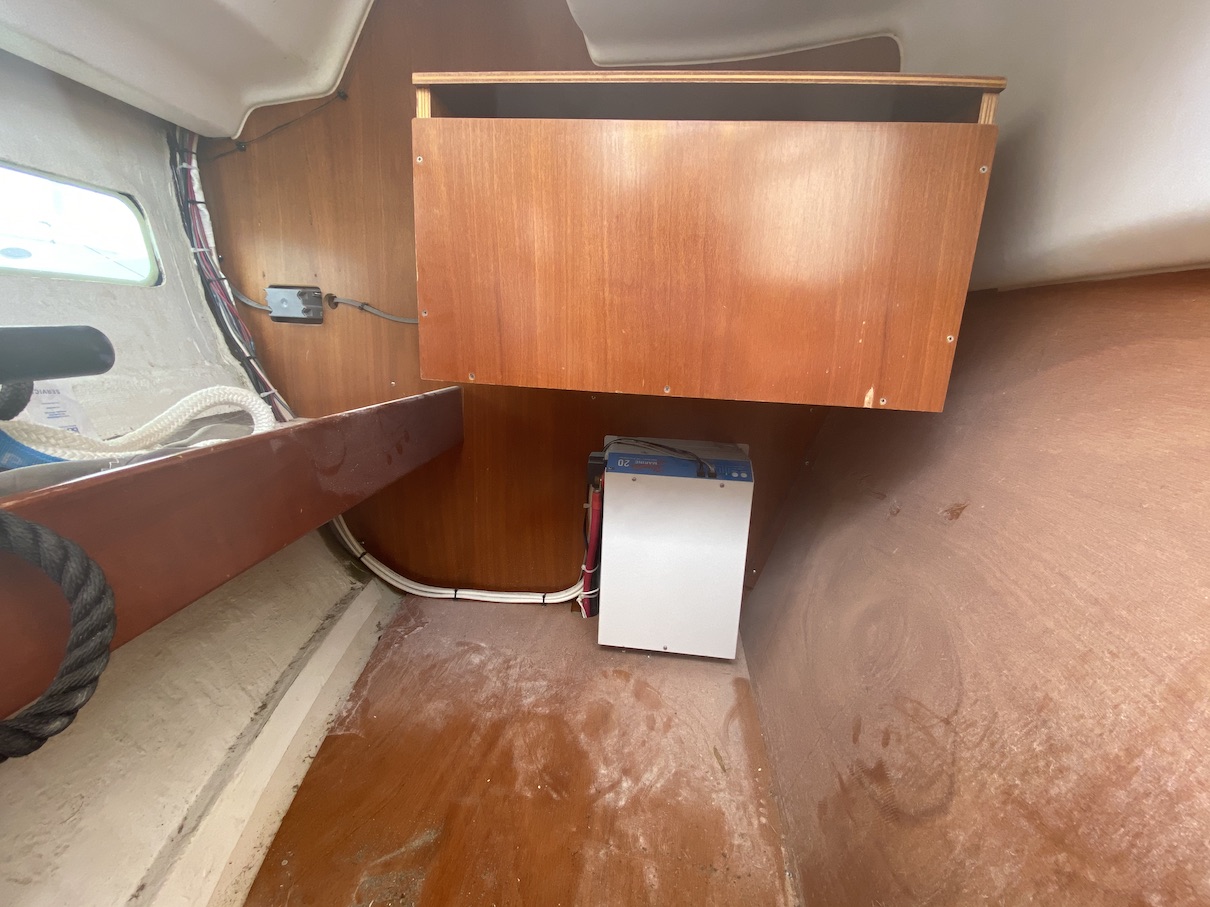

Thanks for the picture. On the other side of the plywood wall, under the berth is where my house #1 and engine start batteries are located. So two of those Fireflies would fit and be more centered over the keel. Just a thought.
I think I'm still going to go with the LiFePO4 Victron batteries but need to check the dimensions to see how much will fit under the berth.

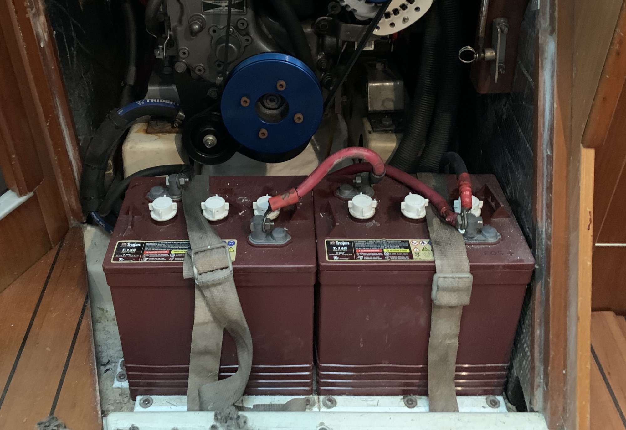

BTW, does anyone here have a 4D house battery under the companionway in front of the engine? I currently have a pair of golf cart batteries but I'm looking into a 300Ahr lithium which is the 4D size (~16.73x13.5x10.79). It seems like it may be an inch wide?
Jun 9, 2020
32
Beneteau 361 North East, Maryland
There is a Deka 904D under the stairs in front of the engine (Deka Battery Model 904D ). 2001 Beneteau 361.
