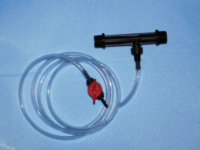

I installed this and it works perfect $ 20 on amazon or less on ebay bilge stays bone dry . it has a built in check valve however I also install another external check valve .5 lb from McMaster carr as a failsafe from backflow of water thru suction tube . It has never clogged as your a/c water should be going thru a strainer

Don. What's the connection about venturis and water bed stores?
They sell or give them to people buying waterbeds as part of a kit to be used to empty the bed.
Typically connects to a faucet routing the flow through the venturi and out a drain while the venturi sucks the bed dry.
