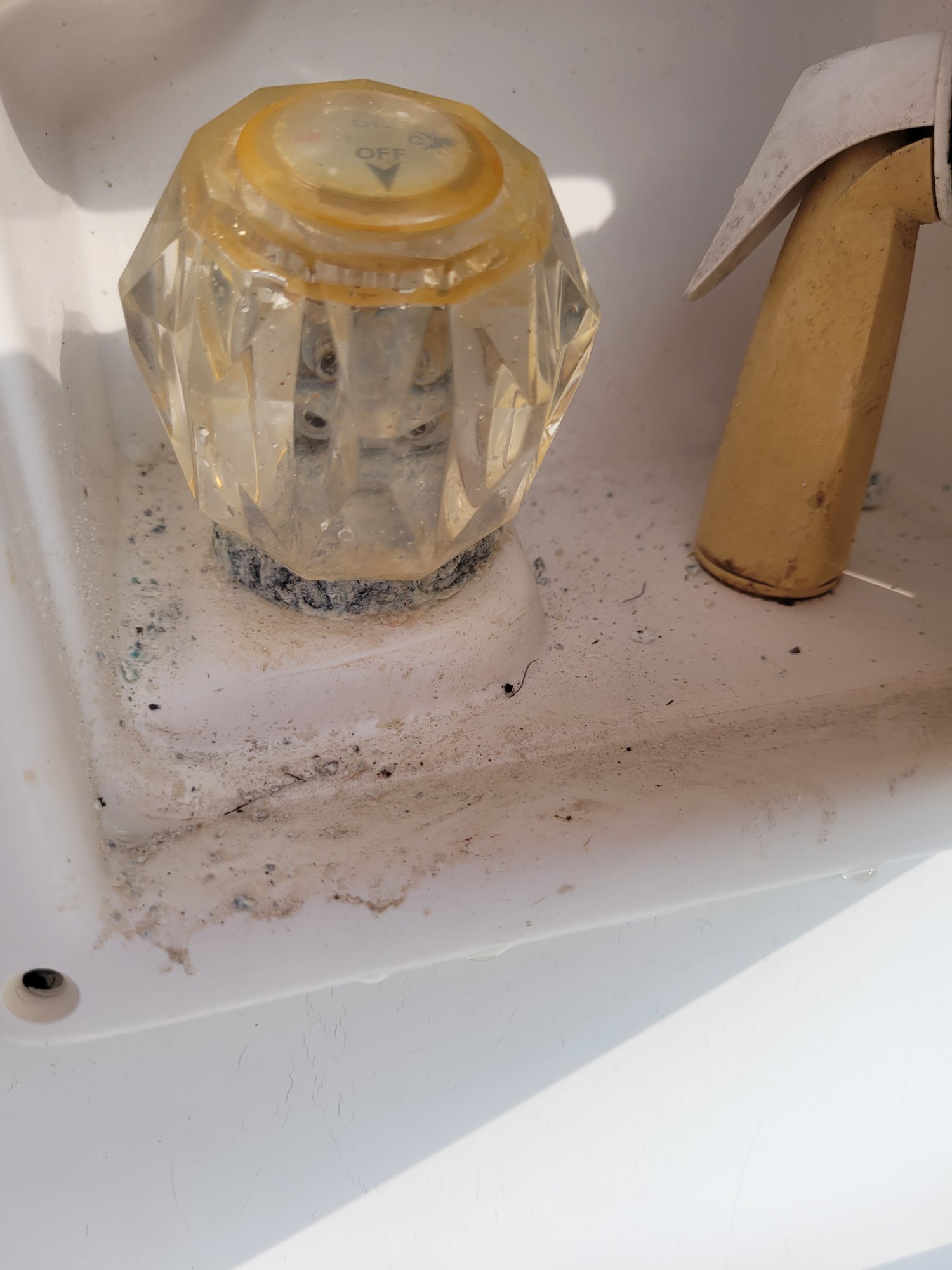

Running thru my repair list and got to the cockpit shower. The faucet is corroded and I sense it's leaking after inspection/removal of the handle . It's a hot/cold faucet and I'm looking for advice on replacement parts or tips/ tricks.

Once you remove the faucet and shower, it may be replaceable at your local big box hardware store or an RV store for a lower price than at a marine store.
You'll need to access the faucet from below to remove the hoses and mounting nut.

Yes. time to replace. If you wish to replace with OEM or very similar in style, try Beneteau spare parts website. Also, Scandvik is a well known manufacturer of marine and RV plumbing fixtures. Many marine chandlries have Scandvik fixtures and you can browse the selection in Scandvik's online catalog. Seeing the amount of corrosion present on your fixtures, I would use a marine grade replacement.

Is there a cover for the shower enclosure? I think the ones I have installed had a cover or at least a cap. Your existing shower seems to have a lot of UV damage.

Yes, my shower faucet has a cover. It's a verticle door that opens out. It covers the faucet and sprayer. You see why its moved up on my repair list.
