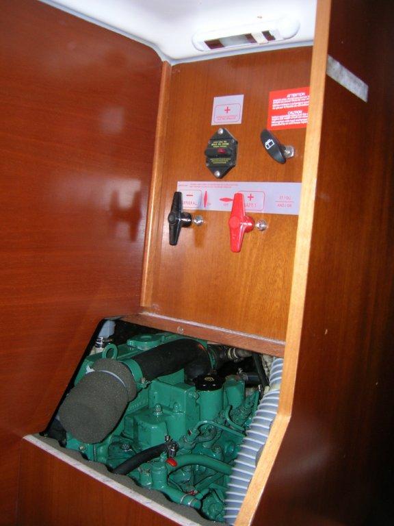

Have you checked that fuse (or switch whatever is called; see the photo) where the three (two red and one black) switches are? Could be simply that.

On our 361 the breaker for windlass is on the front of the starboard side bunk. The breaker should be somewhere close to the batteries and high amp. Id expect it to look like this:

There is a circuit breaker on a bulkhead in close proximity to the ship's battery that provides power to the windlass. It will be rated in the 80 to 90 amp range. The 3 amp fuse you found protects the windlass control switch/remote. Find and procure a Beneteau owners manual specific to your boat.
