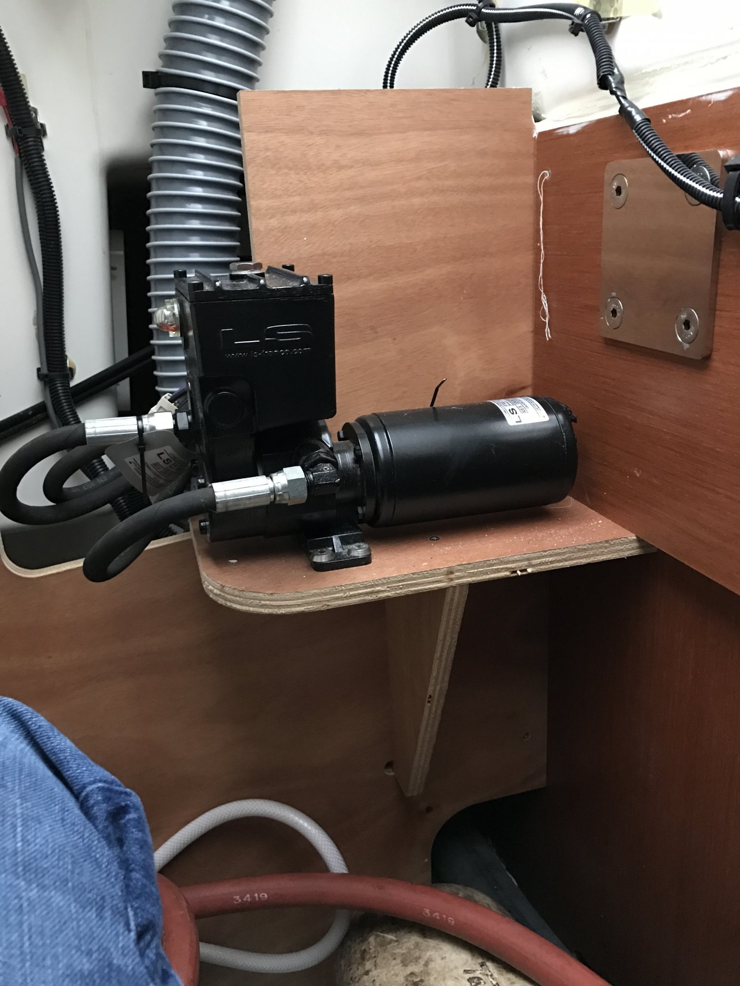

Should be no need to switch to hydraulic steering. We have cable steering with a hydraulic autopilot ram that connects to the rudder post. In general an under deck ram like that is more expensive than a wheel pilot but much more robust. Ours works very well and has plenty of power.
Here’s a couple pictures of the pump and ram:

Below deck APs should connect directly to the rudder post. Edson makes a short tiller arm for this purpose.
A wheel pilot on a 36' boat will only work well in the most benign conditions, when the going gets tough as with gusty winds or bigger seas the wheel pilot will not be up to the task.
