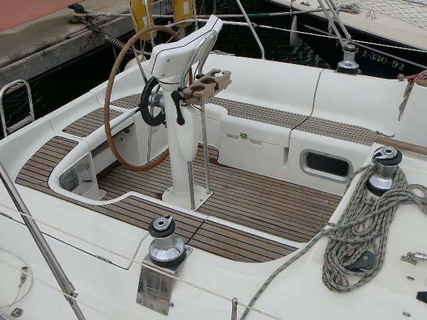

Don't have anything to offer other than a desire to do the same mod. The 361, the model that replaced the 352, has the primary winches on the cockpit coaming at the wheel. Your boat is non-standard. The basic model came with only two coach roof winches and it is a challenge when single handing.

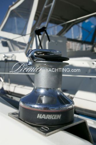

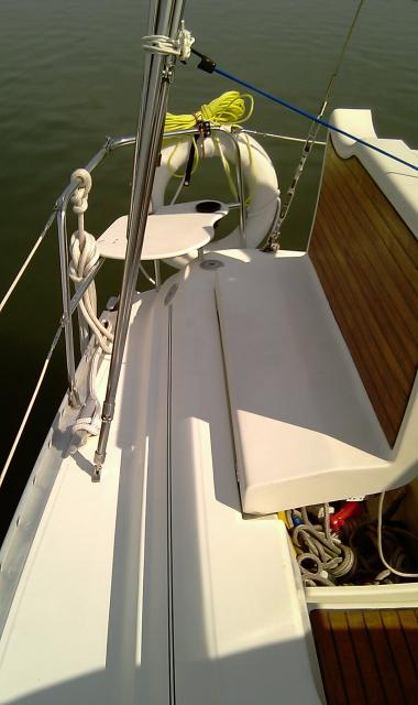

I have come up with an idea. I have also purchased some Harken 40 ST winches that were on sale for 1/2 price.
I will need to reinforce the coaming with extra layers of fiberglass.
I'm working on the CAD drawings for the Winch bracket and hope to have something soon.
Attached is a photo from from a boat that has the bracket but it's not a Beneteau, but the idea is there.:D

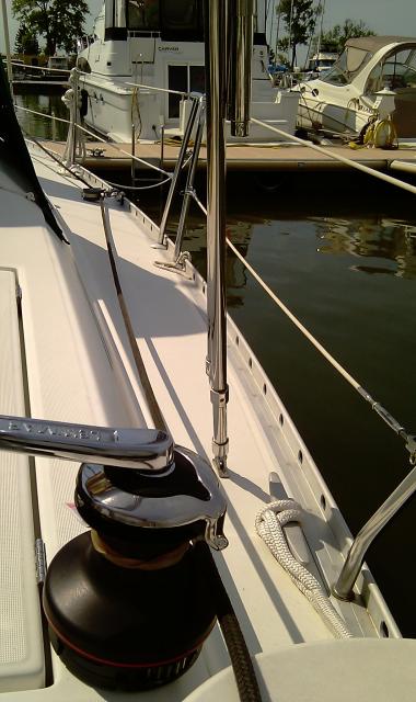

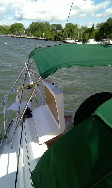

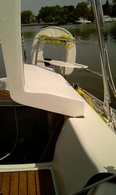

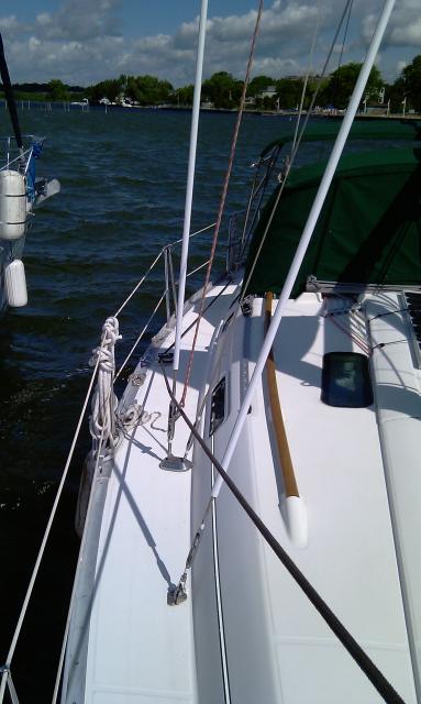

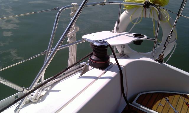

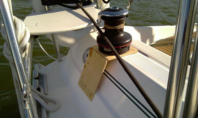

Attached are some pic's of a mock-up sort of.
I can see that there are a few views of this thread. If anyone sees a flaw in my logic please speakup.
The one downside is that the port and starboard lockers can only be opened to the 90 degree mark. They need to be tied off with a bungee cord to prevent one from losing his head. I think I can live with that.
You'll notice that the location is on top of a dividing wall which serves as a reinforced area. I still believe I need to beef up the coaming (On the inside)with some extra layers of fiberglass. Will also use SS backing plates.
Then use a toerail padeye with block arrangement as shown. I'll leave all the existing hardware in place so that when I have sailors onboard to help, it will be easy to run the line back the original way.

This is a alternative location.
You still can only raise the lockers 90 degrees.
It's a bit tight on the starboard side due to the fuel and waste discharge ports but it might be doable. No Bracket would be required, only a base.
I would have to remove the corner seats which I don't use that much anyways.

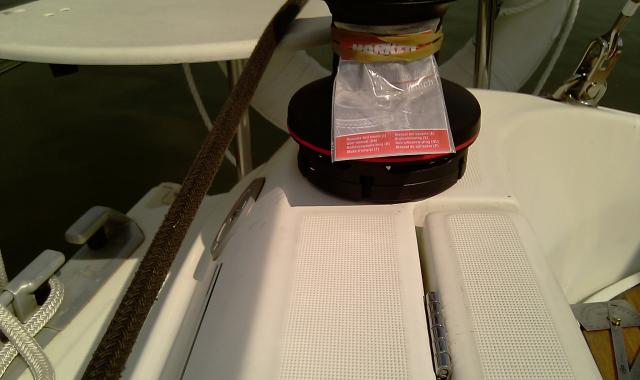

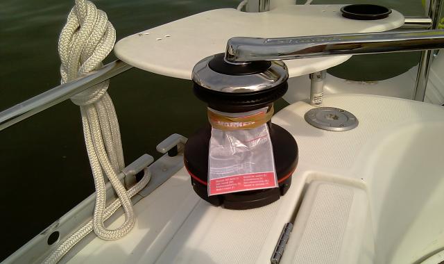

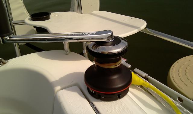

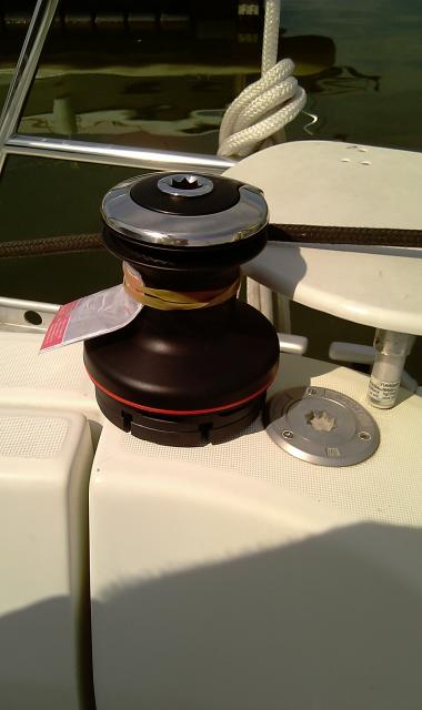

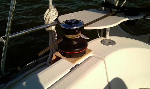

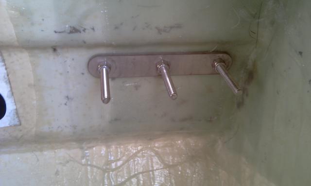

A little update on the progress.
Brackets are back and don't look too bad for $150.
Added some pictures.

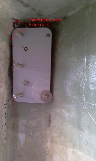

Main backing plate needs a bit of triming to avoid some of the fiberglass.
Not sure if I want to put some marine plywood between the fiberglass and the backing plate since the fiberglass is not even throughout.
Fiberglass thickness at the coaming under the bracket is now 1/2" thick.
I may put an angle bracket from the backing plate to the bulkhead for additional strength.
Also need to trim off the screw lengths.
That's it for now. I have to do the Port side next.

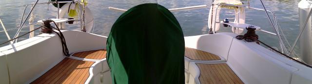

Added a few more pictures. Can't have too many.

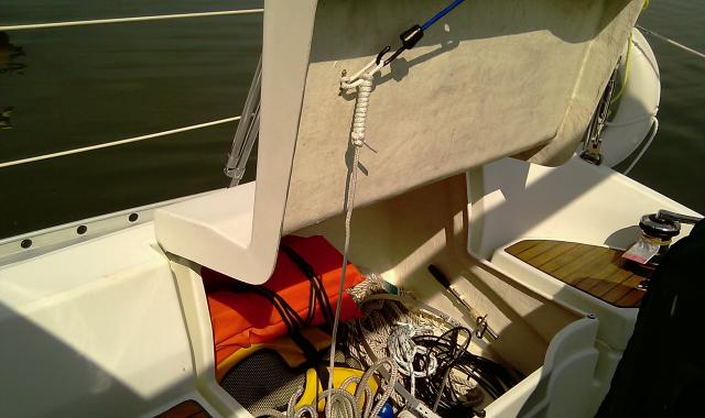

One shows the shows the starboard locker open. I have an idea of using a car strut for the lockers. Something like the one ones used on hatchbacks.
Another project but not right now:eek:
One photo shows the lanyard from the genoa to the winch via a block on the toe rail. The block and toe rail clamp where already aboard.
I'm still leaving all the old rigging in place so that it can be easily converted back when more people are on board.
Total cost so far has been about $1560.00 and that includes the 40.2 ST winches that were on sale.
