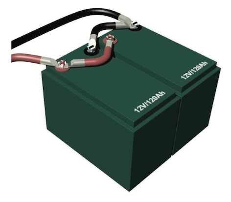

Looking at your parallel wiring, does the positive and the negative go off the battery on the right in the picture (port side)?
If so, you may want to change that. The negative should be on one 'end' of the parallel setup and the positive should be on the other.
To minimize cable runs for your setup, leave the positive connections as is. Move the rightmost (port) negative lead coming off the bank to the left battery (starboard) negative post. The negative cable between the batteries stays the same.
This ensures better charging and discharging performance.
Third page of this document (second image down on the left) shows what I'm describing.
https://enerdrive.com.au/wp-content/uploads/2015/04/How-to-connect-batteries-correctly.pdf
