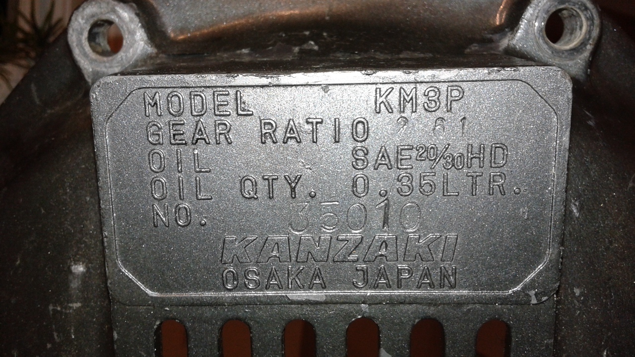

Can't help you with the wood panel, but yes if your Yanmar has the Kanzaki transmission it uses SAE lube oil. The plate on mine shows 20/30 HD

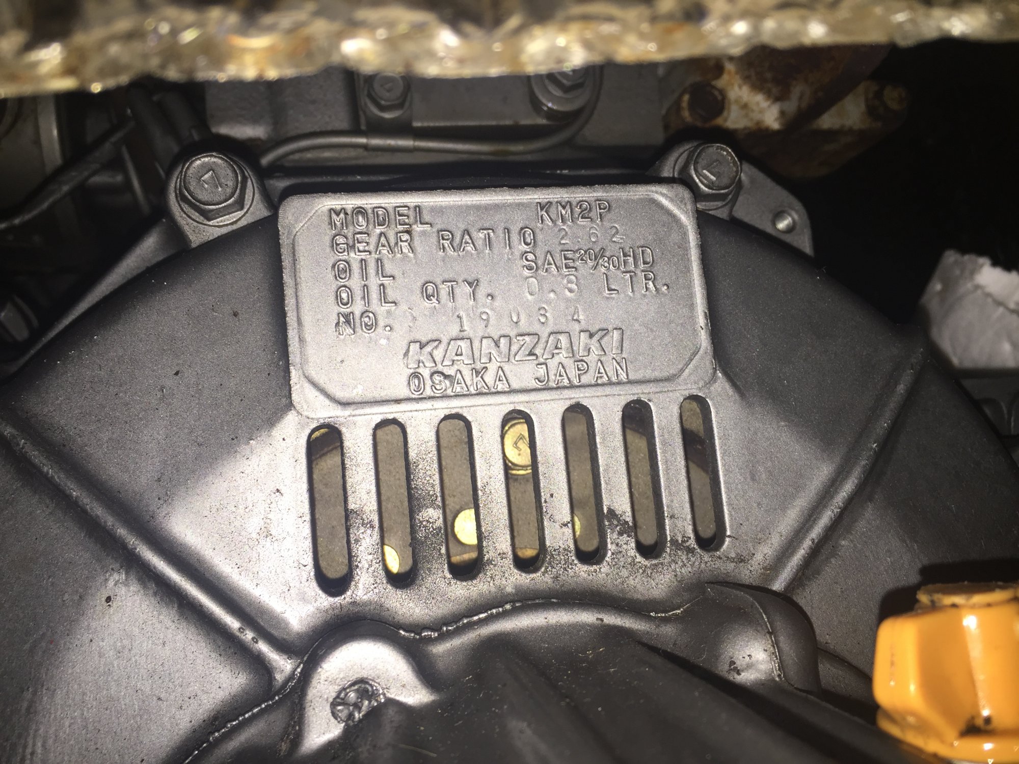

Thanks everyone, I did get the shelf off at the rear of the engine.
My Beneteau 323 has the Yanmar 2GM20F engine and Kanzaki KM2P marine gear.
The Yanmar manual states that the marine gear oil is the same lube as the engine.
The Kanzaki KM2P plate says to use SAE 20/30 HD oil.
I'm using 15W-40 diesel engine oil in the engine.
So should I use the 15W-40 or the SAE 20/30 HD oil?

I would use the HD 20/30 oil as called for on the badge plate.
Where did you get the engine oil reference? I think I am running 30 wt in my Yanmar...
