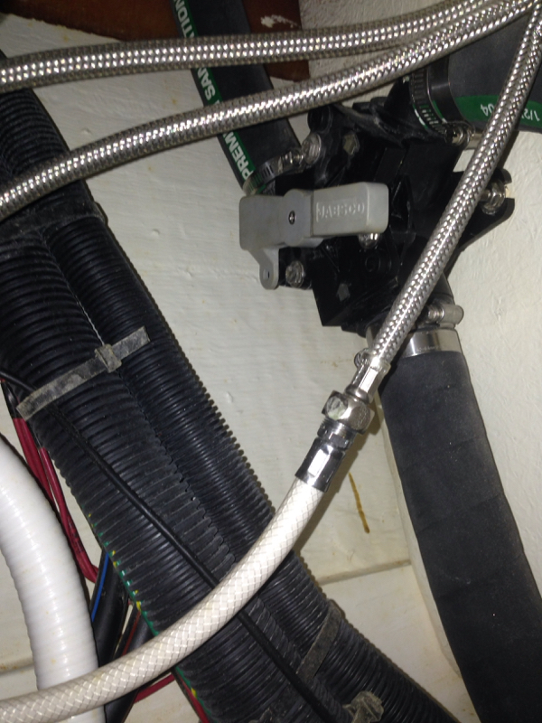

Can anyone tell me if this diverter y valve is in the correct position to discharge into waste tank
Thank you

Can anyone tell me if this diverter y valve is in the correct position to discharge into waste tank <img src="http://forums.sbo.sailboatowners.com/attachment.php?attachmentid=88916"/> Thank you
A simple way to find out is to pump five gallons of fresh water and then check the holding tank. If it's going overboard, it's just fresh water, no damage. If it's going into the tank, just water, cleaner pumpout
