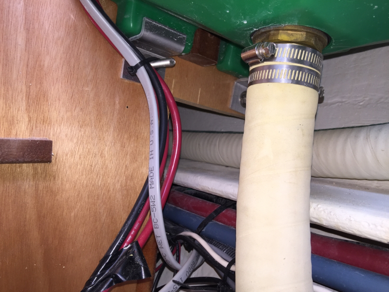

According to the Beneteau factory a/c install diagram, there is a 5" duct that exits the lazarette along a shelf-like protrusion from the hull. As the attached photo shows, there isn't nearly enough room -- at least, not without repositioning the holding tank... Aargh

In the remote event that another Beneteau 323 owner actually read this thread, here's an update: I had a local year emulate the Beneteau factory install, so far as possible. The result is acceptable but not terrific, due to the low location of the two vents (under the nav table and at the rear of the aft cabin). It was not possible to feed 5" ductwork from the lazarette (where the a/c unit is mounted) to the main cabin - we had to use 4". The seacock, filter, and pump are positioned under the aft cabin berth, next to the existing engine seawater intake. Condensate is pumped overboard by a sealed shower sump with a level-activated pump inside.
